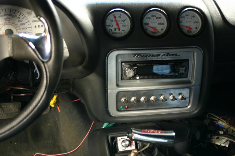

I have the AutoMeter full sweep 2-5/8" Sport-Comp gauges for fuel pressure (electric) and nitrous pressure (mechanical). You definitely want a full-sweep gauge, and the 2-5/8" diameter makes them easier to read accurately. You want the most accurate read you can get on fuel pressure and nitrous pressure. One of the advantages of the Firebirds is having the A/C vents available for the 2-5/8" gauges.
I also run the 2-5/8" full-sweep mechanical on oil pressure for the same reason. The only 2-1/16" 90-deg sweep guages are for oil temp and tranny temp (both electronic), in the A-pillar. For those, you just need to see roughly whether you're on the hot side or the cold side.... absolute accuracy is not as critical.
