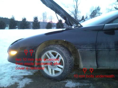

Step 2: Pop open the hood of your car, and unbolt the top row of bolts there (10mm). They are very easy to see, but are circled here on the picture. The white circle, is where you may elect to work something else. Where that white circle is, are two phillips head screws into the front bumper cover, which is on a small bracket that is the forward-most 10mm bolt. While you don't have to take this bracket off, or even touch the screws, some people like to use the T15 to remove the headlamp assembly, and then take the screws out as well. That's up to you. I was able to just toss a socket on a 1/4 drive ratchet, and pull the bolt out easy enough without it.

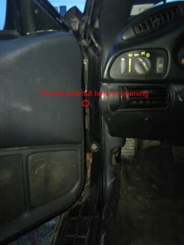

Step 3: Open the door to the car on the side you're working on (naturally). There is one 10mm in the inside as well, approximately where I've put the circle on this picture. It's hard to photo, but should be obvious when you actually look. This is where you'll need your extension. Ideally, don't drop it when you take it out

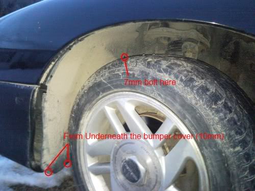

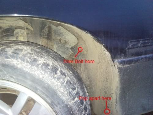

Step 4: The fun part. You'll want to remove the inner fender cover, to provide easier access to two more bolts. There are a few 7mm bolts (though one side of mine was replaced with screws instead. Use whatever you need to remove them). They're circled on the next two pictures, approximately where they are. There are also two from underneath, in front of the wheel. You'll want to remove them (and if you have a cap on the bottom rear, pop it apart), and pull the cover out from the wheel well.
Step 5: There are 4 more bolts to remove now. Two under the fender, behind the wheel. They're easy to see, just bend down, and unbolt those. The last two, are up underneath the fender, attaching the front corner of the fender, to the bumper cover. There are two 10mm bolts/nuts, with a backing plate (which is about 8 inches long by 2 inches wide, and will come off after it's unbolted). The reason to remove the inner fender cover, is so you don't kill yourself and break things in frustration trying to unbolt these last two. They're annoying to do by hand, simply because of the angle.

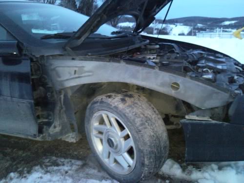

Step 6: Once they are removed, you are now "free" to remove the fender itself. Thankfully, the fender is fairly flexible, however you don't want to go nuts with it. The top of the fender, hooks over the rail, as you'll see when you remove it. The trickier part, is where that bumper cover and fender come together. And the only reason that is, is because where it mounts, the fender tab is sandwiched between the support, and bumper cover. At that point, you'll be able to pull the bumper cover down clear of the bolts, then the fender to follow, then lift the fender up and off the car.
