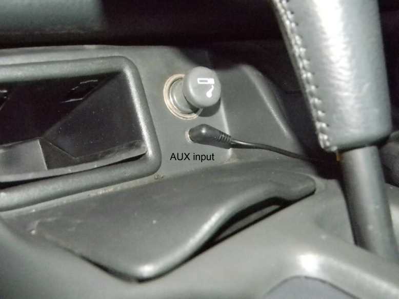

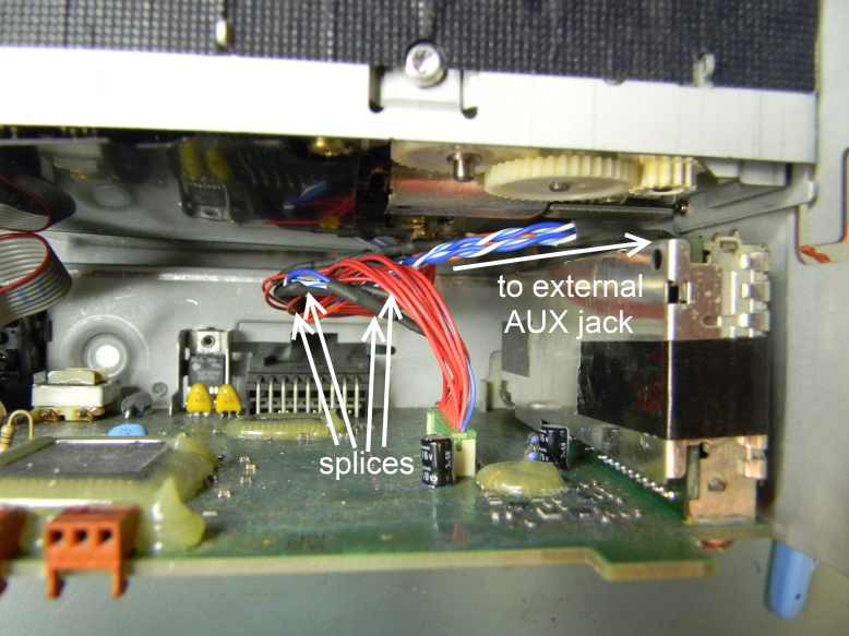

I am not aware of any Bluetooth mod, but I have done a modification to add an Aux socket. It involves cutting 4 wires from the main circuit board in the head unit to the CD drive. You route those wires to an external jack. The jack normally routes signals from the drive if nothing is plugged in. The only real problem is that you have to keep a CD in the drive playing all the time while you hear audio from the Aux jack.
I know there is a kit that involves connecting to the cable to the external cd changer in the hatch area to do the same thing. At the time I did my mod, I did not have the external drive. That method has the same drawback with having to have a CD playing in the changer to use it. With both methods, that is because the head unit will not use those wires unless there is a CD playing.
