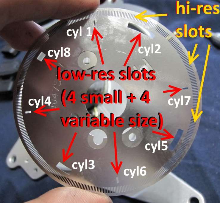

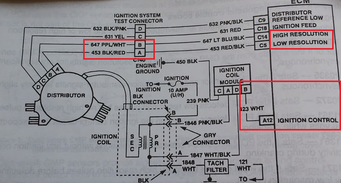

The Opti puts out two square wave pulse signals alternating between 0 volts and 5 volts. Low resolution signal has four variable width pulses per crank revolution (variable widths define which cylinder is approaching TDC), used to time ignition and injection. High resolution has 180 equal width (1° off/1° on) pulses used only to define the exact engine RPM in between low resolution pulses. The Accel is not one of the better choices. Unfortunately, there are fewer decent units available as time passes.

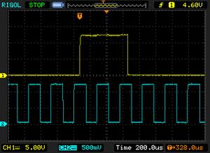

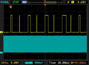

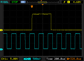

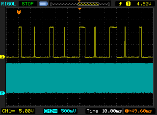

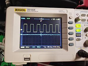

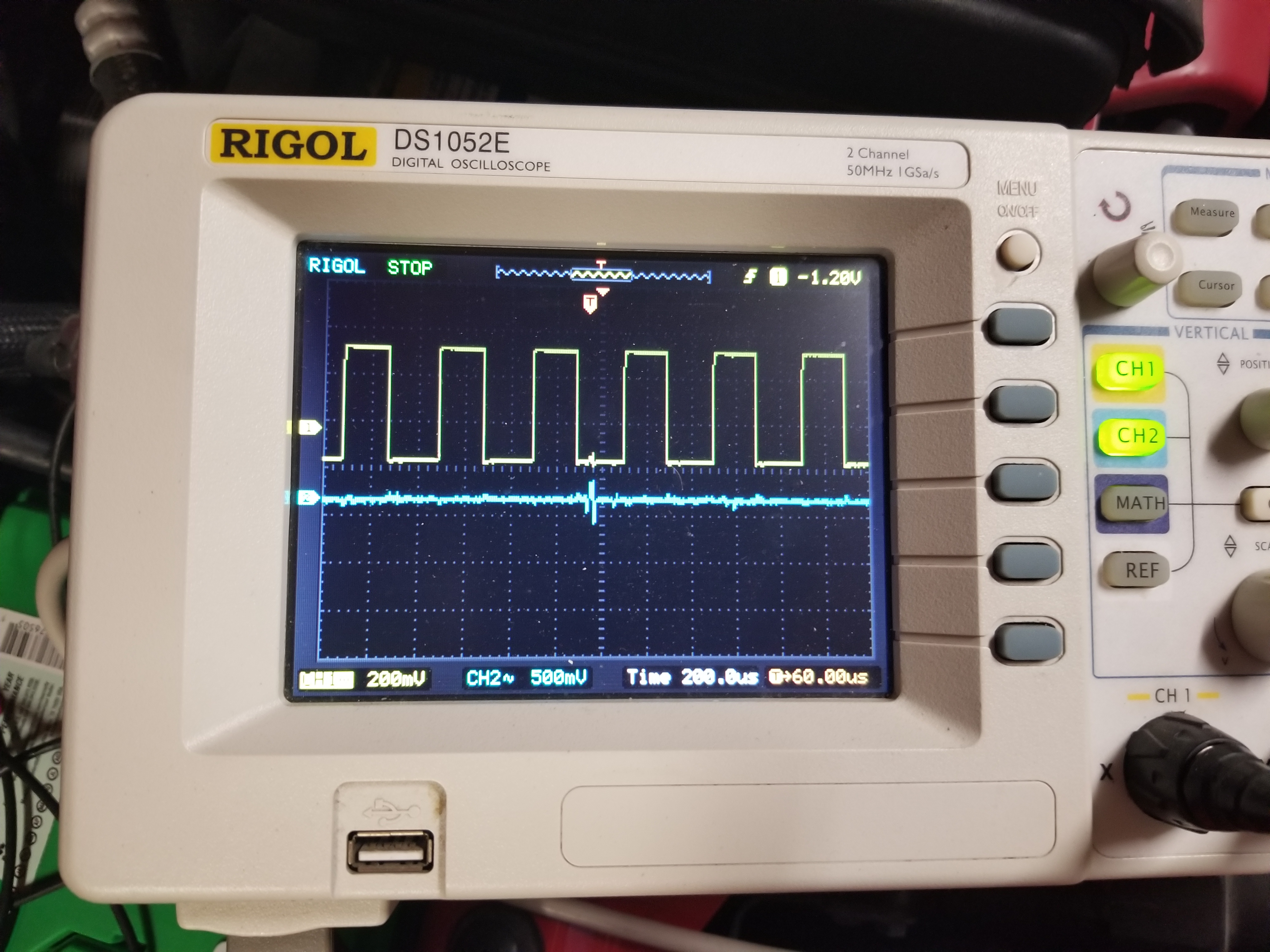

Here are some o-scope screens showing the low resolution pulses (top trace) and the hi res pulses (bottom trace). The signals are the same in each shot. In each one, the time-base (shown at the bottom of the screen in white characters in time per division on the screen) has been changed to show the selected waveform (low res or hi res) in the best way. This was done with the outputs pulled up to 12 volts so the voltage is higher than the normal 5 volts. These were taken using an artificial way to rotate the shaft outside an engine, so they may be in the opposite direction from normal. Also shown is a photo of the timing wheel with explanations of each signals function relating to cylinder number. For the low res signal, there are 8 pulses per cam revolution, 4 same-length narrow ones and 4 variable-length wider ones.
Re: 96 Trans Am Stumbles & Dies in drive at a full stop

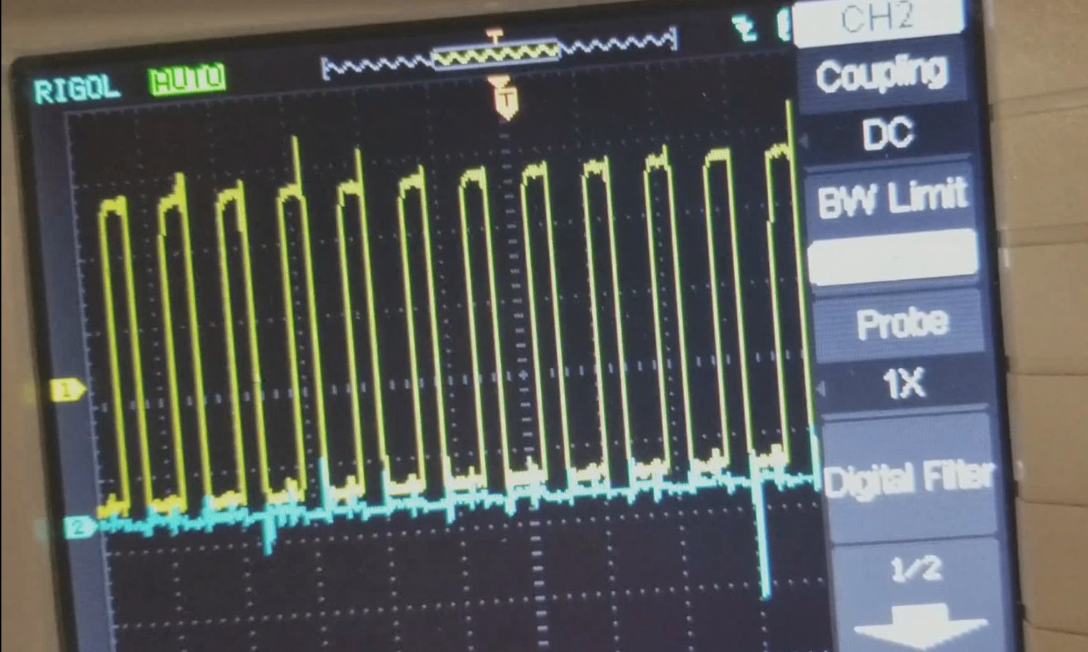

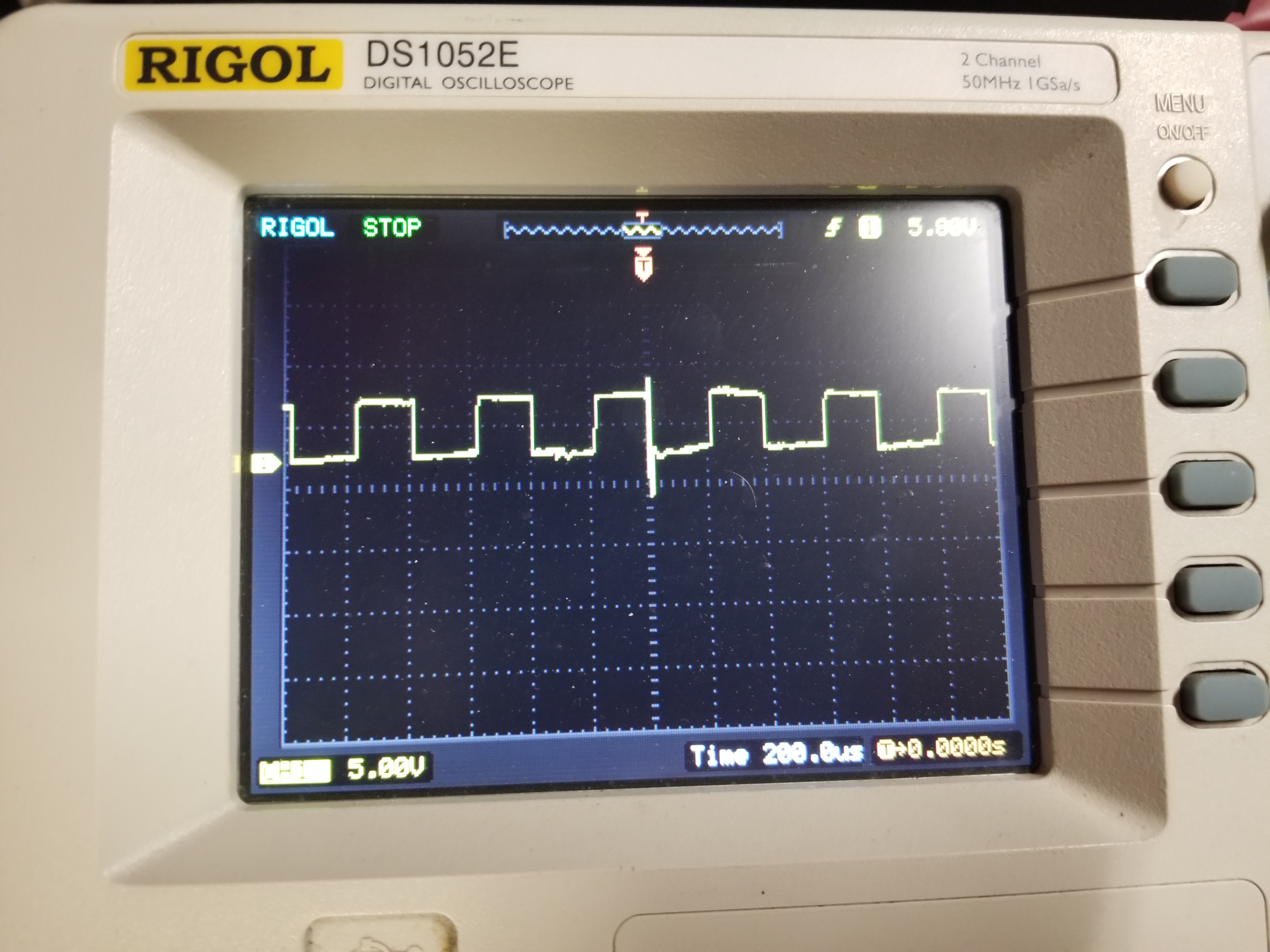

Thank you both very much for the information - My O-scope looks exactly like the one in the pics (Rigol DS-1052E) - The car will be back to me on Monday and I will test the Opti 1st and foremost.

Ok so I did some testing tonight on the ICM and the Opti signals.
1st - I removed and ohmed out the Opti connecting cable - all pins .5 ohms - it's good.
2nd - all voltages were correct at the ICM per shbox's website.
3rd - See pics of the signals from the PCM at the white wire on the ICM. It looked ok to me - guru's please let me know. (Last 2 attached pics taken with AUTO mode on.)
4th - See the diagram attached of the wiring I used to obtain the signals.
5th - I was able to get 1 of the signals (I believe the high resolution) directly from the opti. I was not successful in getting a good image of the low resolution?. Not sure what settings I need to be using on my o-scope. Voltages were not the same as listed above since I didn't pull anything up to 12 volts etc.
Attached are the images I got.
