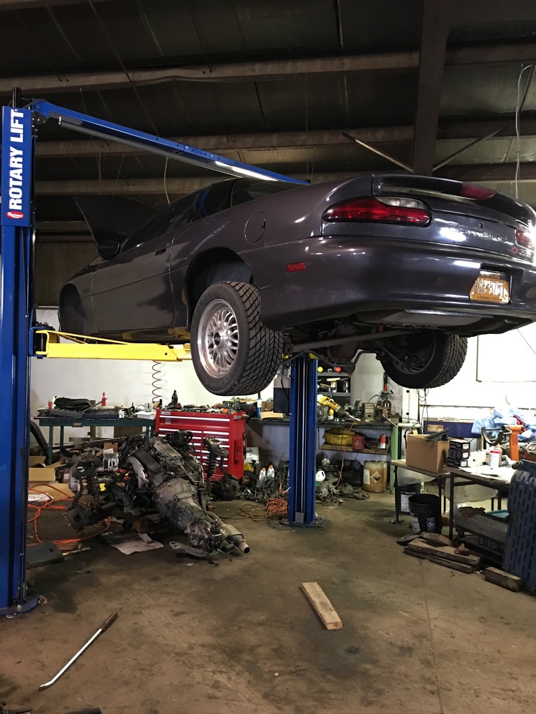

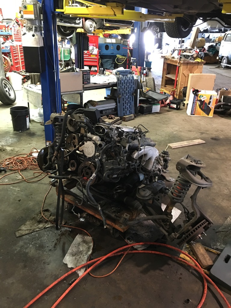

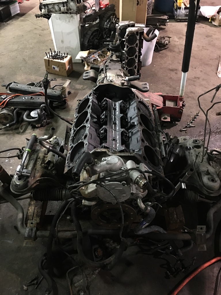

Hey everyone! I'm a long time lurker and decided to share my build. I spent a lot of time researching, and here's what I've come up with. My budget is about $2500 overall. We dropped the cradle, and all work will be performed by me with some help from a friend who is allowing me to use his lift. Engine is currently stock with 113k on the clock. 1994 PPM Z28 M6.

Pictures of the progress so far:
