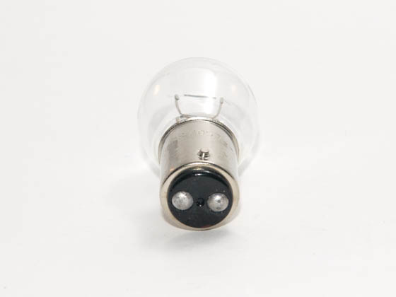

Okay so I pulled the bulbs out for driver's side and passengers side brake lights
DS = 1.3-1.4 ohms and PS = 2.1 ohms I placed the meter on the bottom two bars where the two bumps on the bulb are located... is this why the DS is dimmer?

I don't know for sure how to measure these 3-wire sockets with running light and brake light all in one socket and a dual filament bulb 2057...
anyone know?
The wires are labeled A,B,C but on my camaro they are grey, brown & black
A=Grey
B=Brown
C=Black
A & B are for the filaments I believe as there are two contacts on the bottom of a 2057 bulb
One for Running Light and the other for Brake Light
I'm not sure what the Black wire (C) is for... I 'believe' it goes to the ring around the socket area that makes contact with the sides of the 2057 bulbs base or non-glass area and non-bottom of the lamp.
