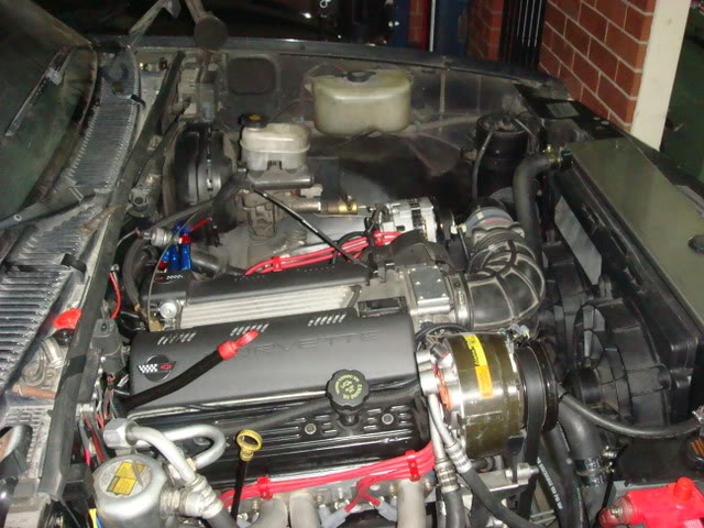

I did a 1996 LT1 A4 engine swap into my 1989 C1500 Truck. Everything is working perfectly with the exception of the A/C.
I need to know if there is a way to command the PCM to turn on the cooling fans in order to keep the A/C condenser cool when the compressor is running.
I could do it with a relay wired to the A/C compressor clutch feeding the fan motors directly but wanted to hear other ideas first.
Here is a picture of the LT1 sitting in there:
And here from another angle:

Nice bro, ive been slowly getting around to this exact same project as well. You got her fired up and everything huh? How hard was the wiring as far as getting her started? Pm me if ya want, any and all details will be greatly appreciated. Ive been through the LT1 harness numerous times, but not the 1500. How many splices did you need to get her fired up? I see you dont have f-body brackets though, so you didn't have to grind the frame to fit the stock a/c compressor. Are those the vette brackets? Hit me up, very interested in following this build. Subscribing....
I installed the alternator high on the drivers side with a set of home made brackets and re-routed the accesory belt drive:
The original Truck A/C compressor was mounted on the LT1 alternator location.
I used an alternator pulley with a ball bearing as an idler to avoid hitting the truck frame on the pass side.
I also removed the connection on the water pump that was originally used for the oil cooler and plugged it.

I have the A/C controls from the truck running the A/C system. I wired the the A/C compressor hot line to the A/C clutch status input on the PCM (connector B21). This connection does run one of the cooling fans at high speed but it will also set two codes on the PCM and the fan will not stop even if the A/C is turned off. You have to shut down the engine and then the fans will run normally afterwards.
