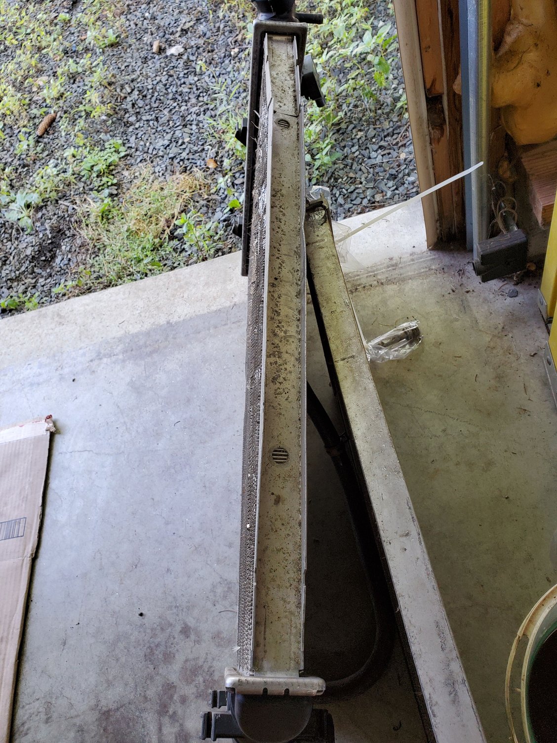

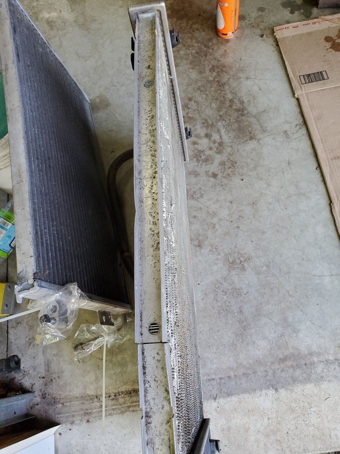

I got the radiator out today. It doesn't really look that great and I think I will just replace it. It looks bent or somehow out of shape toward the top. It reminds me of what the heater core looked like when I pulled that. Obviously the expansion that occurred from freezing stretched and pushed things.

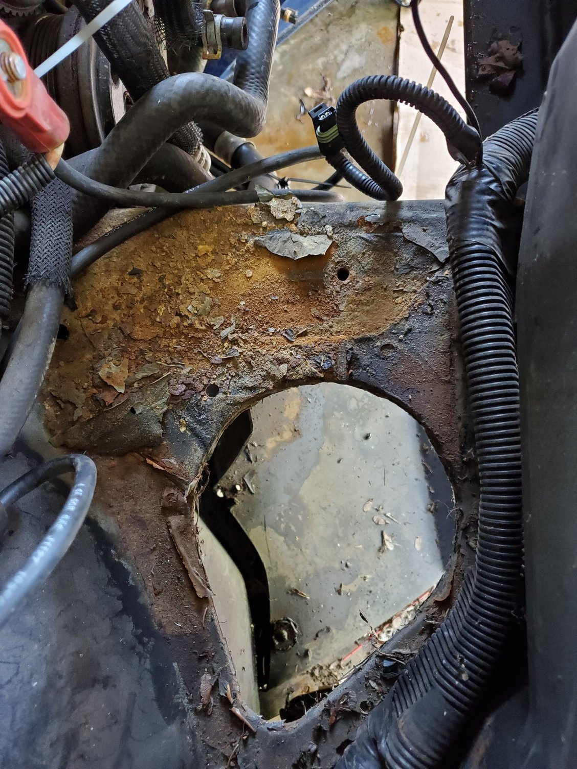

I removed the expansion tank and flushed that out. There was a lot of sediment at the bottom of it. The area under where the battery sits is corroded, so removing the tank has the added benefit of allowing me to discover that so I can arrest it before it becomes rotted.

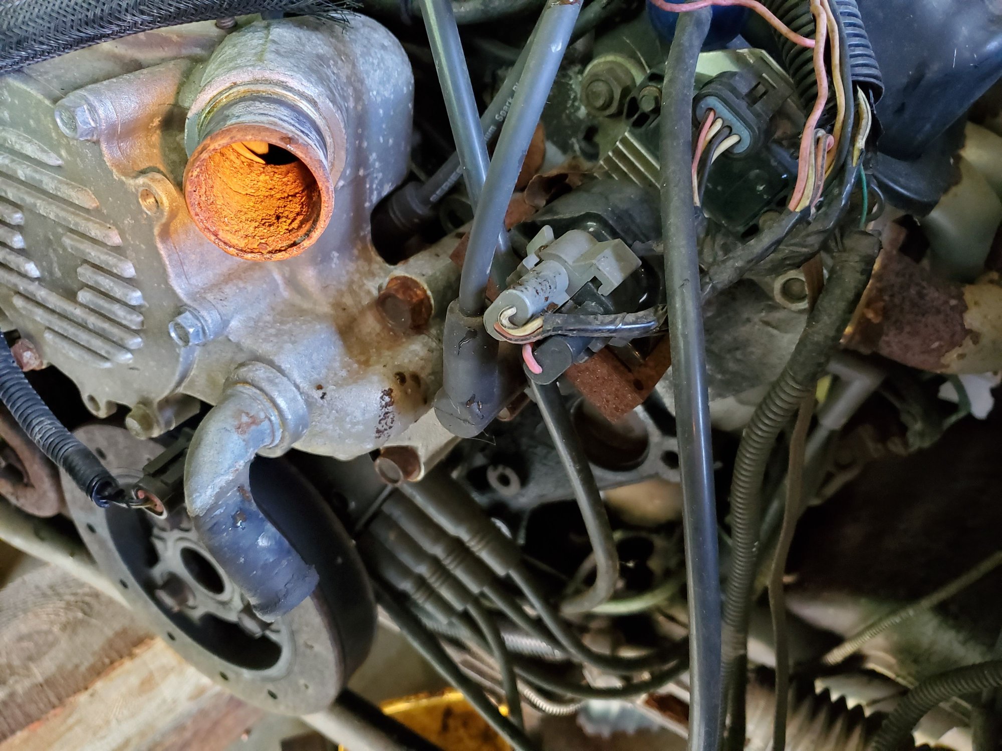

Looking inside where the upper hose connects to the t-stat housing is scary. There is so much rust scale visible. Makes me think I should pull the pump to inspect it.
The radiator was a hassle to remove because of the AC lines that rest in the plastic brackets on the passenger side, and the way the condensor (if that's what it's called) rests in brackets on the front of the radiator. I ended up removing the condenser. Is there a way for me to assess whether it is functional and can be re-used? I would like to have functioning AC in the car eventually.

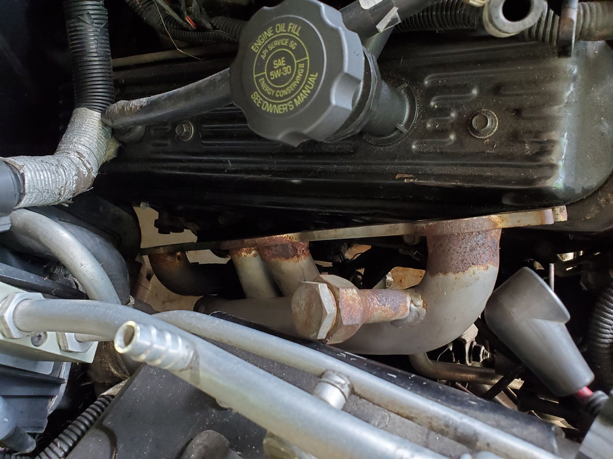

I finished unbolting the headers today, then removed the plugs. I am very lucky in that the header bolts weren't frozen at all. In fact, one or two were loose. I have not found a way to actually get them out of the car. The paths both up and down seem too tight.

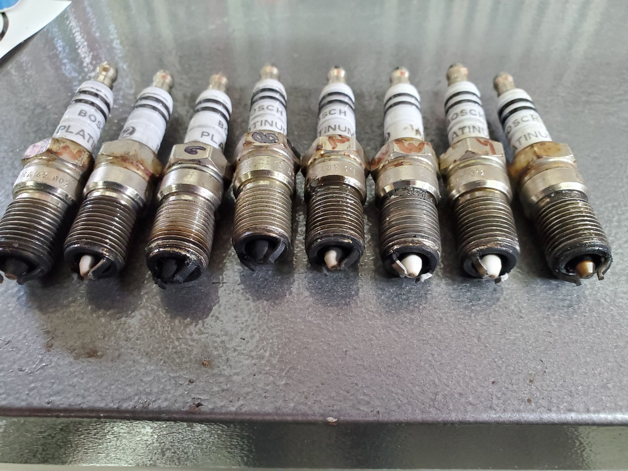

The plugs are concerning to me because I'm not sure what I am seeing. Someone mentioned that coolant leaking into the cylinders would show itself through very clean spark plugs. None of these plugs are totally clean, as they all have black on them. However, four have one part of the insulator that is black and the other side is clean and white. Do you know what this means?

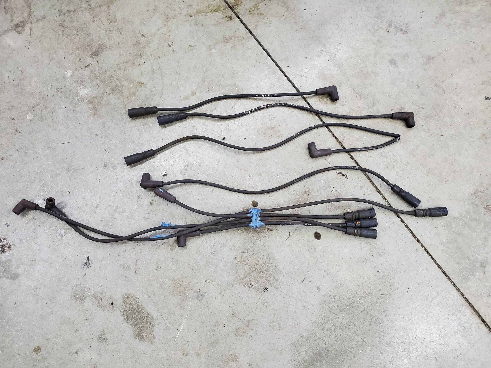

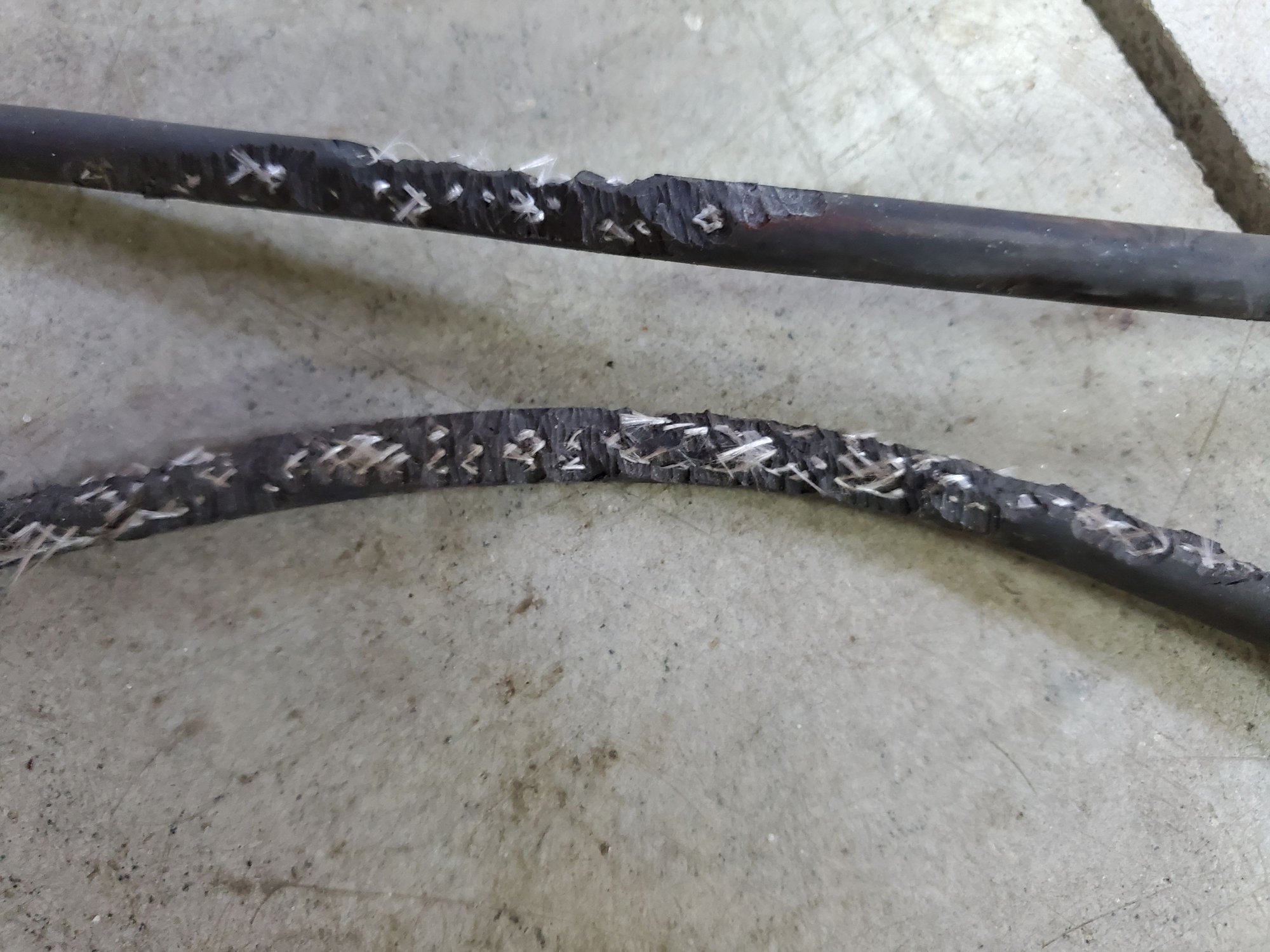

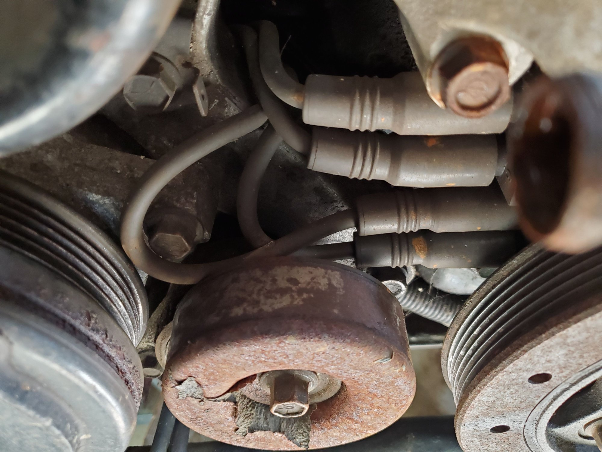

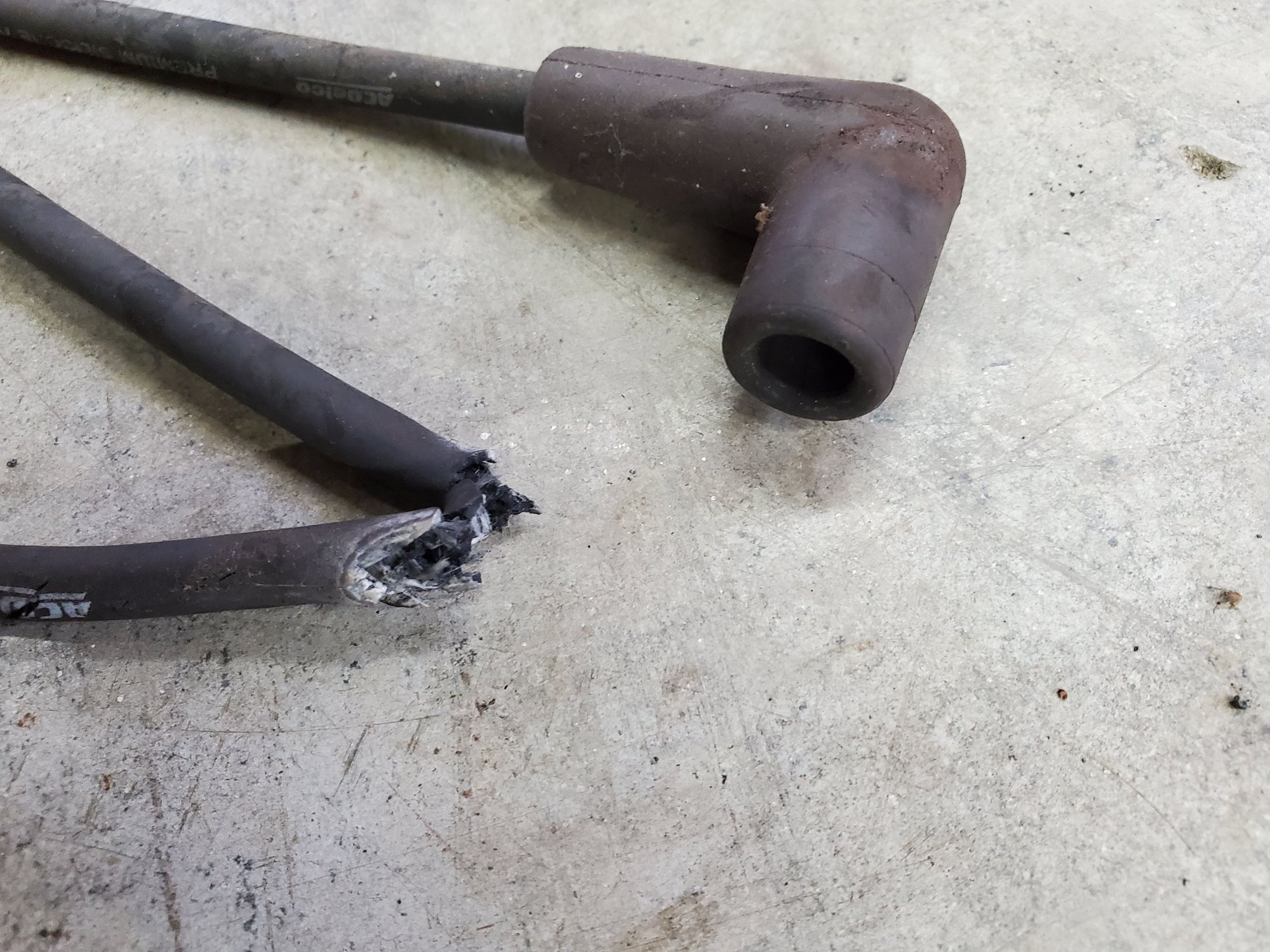

I got the water pump off and the plug wires off. The mice must have been pretty desperate. I can say for sure that cylinder #8 was not firing at all because that wire is chewed clean through. Would the other cylinders have been firing with the insulation as chewed up as the pics show?
A previous owner used some kind of blue putty to hold the plug wires together and secure them to a broken plastic retainer on the driver's side. I will want to make sure the wires are run perfectly so they aren't rubbing against anything or touching anything too hot. Any tips for plug routing and retention on the LT1s?

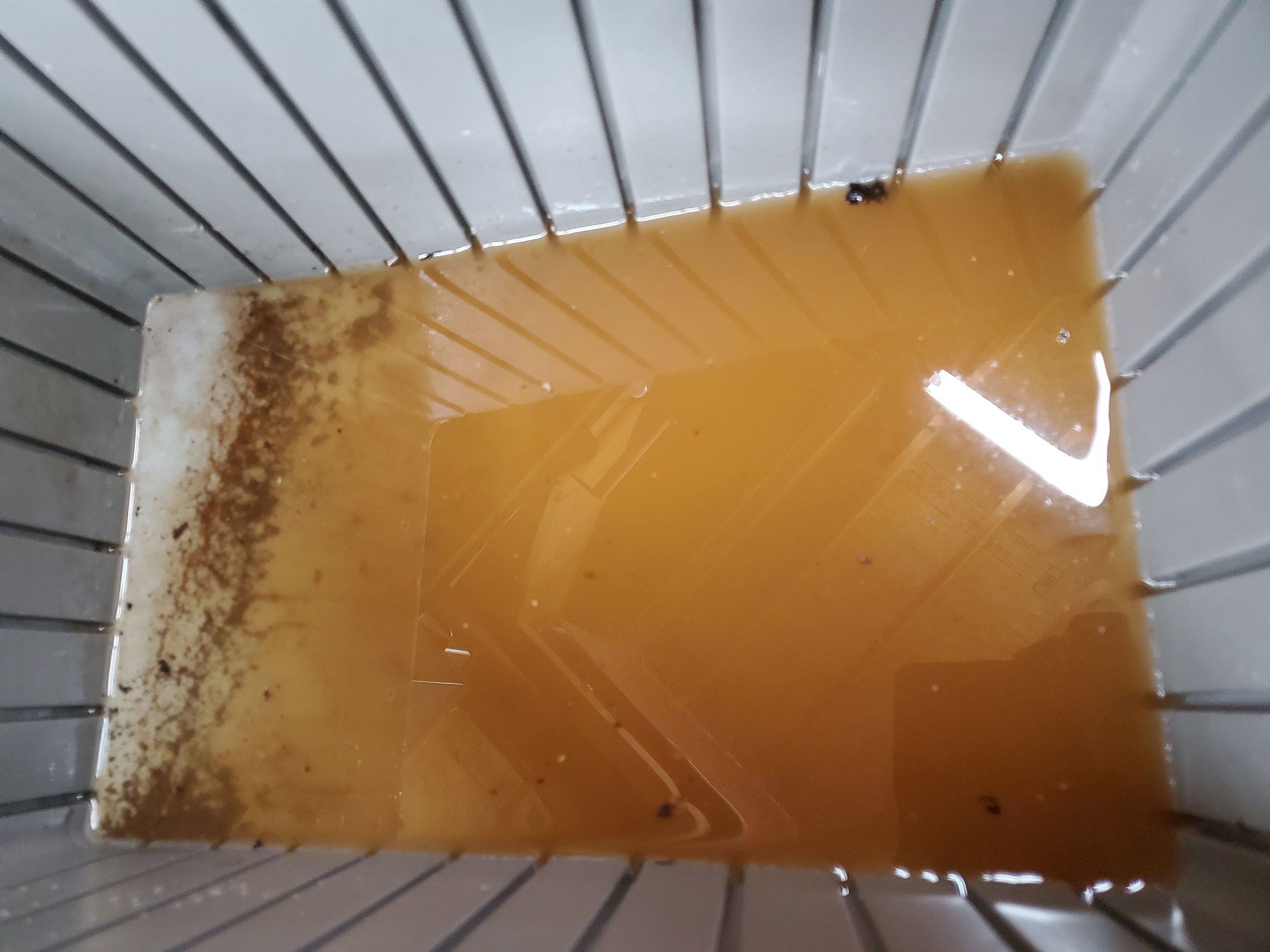

I sanded the rusty area under the battery/above the overflow tank tonight during a short window of garage time. I used the hose to wash off the sanding dust and thought I'd get some higher pressure water into the block. As I mentioned in an earlier post, I have already run the hose through the empty t-stat housing until what came out of the two block drains (knock sensor on PS and actual plug on DS) came out clear.
Well, I blasted water in through the top and bottom holes on the DS of the block behind where the water pump usually sits for just a few seconds and then checked what had drained out. It's more NASTY brown crap. You can see all the sediment visible on the shallow edge of the container as I am tipping it. There is plenty more sediment in there, I just couldn't get it all to settle in one spot for the photo. I also see a large dead spider in the water. It was already dead when I looked at the water, immediately after I turned off the hose, so I don't think he was in the container before I began. I think he was in the engine. It did sit for a long time with two 1-5/8 holes in the block where the core plugs had popped out. I think creatures tried to make a home inside. I'll keep doing this until it runs clear on both sides again.

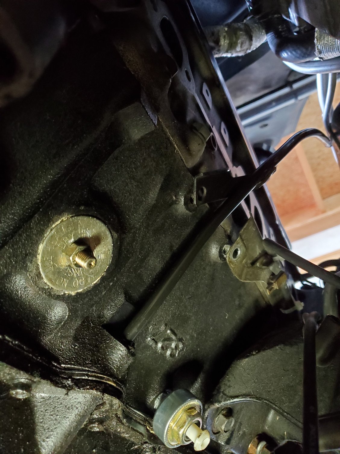

Super-basic question: in one of the attached images, you can see that the bracket for the oil dipstick tube does not line up with the hole in the block for the retaining bolt. It has actually just been loose in the car since I purchased it. I found a correct bolt and want to fasten it appropriately. My guess is that when the PO installed the headers, they needed to move the dipstick and it was a hassle for them to access the bolt. Should I just be trying to bend the tube to make the bracket fit? Once the headers are back in, I am sure I will need to fiddle with the tube so that it clears everything. Are there adjustable aftermarket tubes that are able to be mounted easily in these circumstances?
Another question: what does the "327" stamping on this block mean?
I dropped the starter to clean it up and make it easier to get the headers into place. I have now removed that expandable freeze lug in the picture and will install a pressed in brass plug. I reached my finger into the hole, and my God, there is so much grit that has collected in the back of the block that could not get flushed out of the drains. I'm going to try not to stress about it and just hope that it doesn't plug up my new radiator.

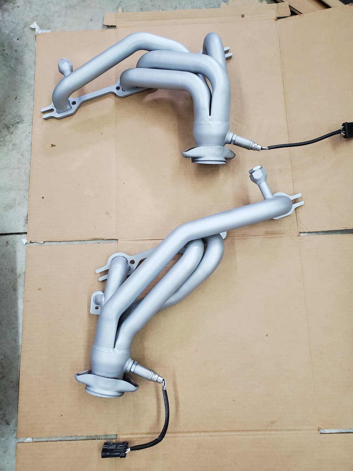

I used a red Scotch Brite pad and a wire wheel to clean up my headers, just to get the rust and flaking coating off as well as I could. I the applied some Ospho to convert and neutralize the rust. Then, I applied some high temp Rustoleum silver Bar-B-Q paint. I have no illusions that this is a long-term solution. I just wanted the headers to look better and I wanted to slow down the rust.
