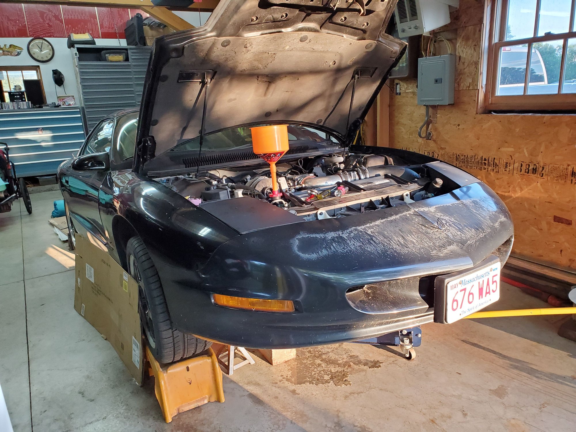

Today's , I got my CPAuto spillproof funnel kit from Amazon. Eagerly awaited for the baby's nap so I could try it out.
I followed the above bleeding procedure step-by-step with no deviation. I got water out of each bleeder pretty quickly today, before starting the engine. Started engine for a few minutes, kept water level in my funnel nice and high, cracked bleeders again. Got water with some air bubbles, closed bleeders again. Got a burp of air inside the funnel. I also pulled the funnel out of the radiator for a second, as Lonnie suggested. Water level in funnel was rising and turning brownish.
As engine heated up, I removed the funnel and adapter and got the cap back on the radiator. Cracked bleeders again and sure as heck, from what I can tell, they were now shooting steam. So, I shut the engine off.

Tonight, I decided to have another shot at this. I watched some videos for how to use the no-spill funnels and it seemed so simple. Insert proper adapter to get a seal, fill funnel 1/3 of the way, run engine and wait for all bubbles and burping to be over.
My experience was pretty different.
There was plenty of bubbling and flowing when the car heated up. There was so much, in fact, that the funnel started spilling over onto my alternator. When I shut the engine off, the funnel emptied pretty quickly and sucked air into the system. That was my mistake to allow that to happen. So, I repeated this process but made sure to have water ready to pour into the funnel so it did not become empty after turning the engine off. The last couple of times that I did this, the funnel quickly filled up and nearly overflowed, but when I shut the engine down it does not empty out, the level just gets lower. I am getting steady water out of the bleeders with the engine off and the funnel full.

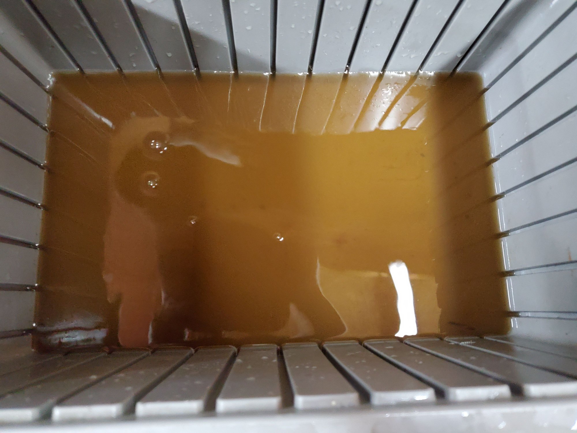

The overflowing coolant that I managed to catch in a container is very brown and there are chunks/flakes in it. If nothing else, the system is very dirty. I see at least one short evergreen needle in the container, but I can't be sure if that was already in there when I grabbed it as the funnel was overflowing.

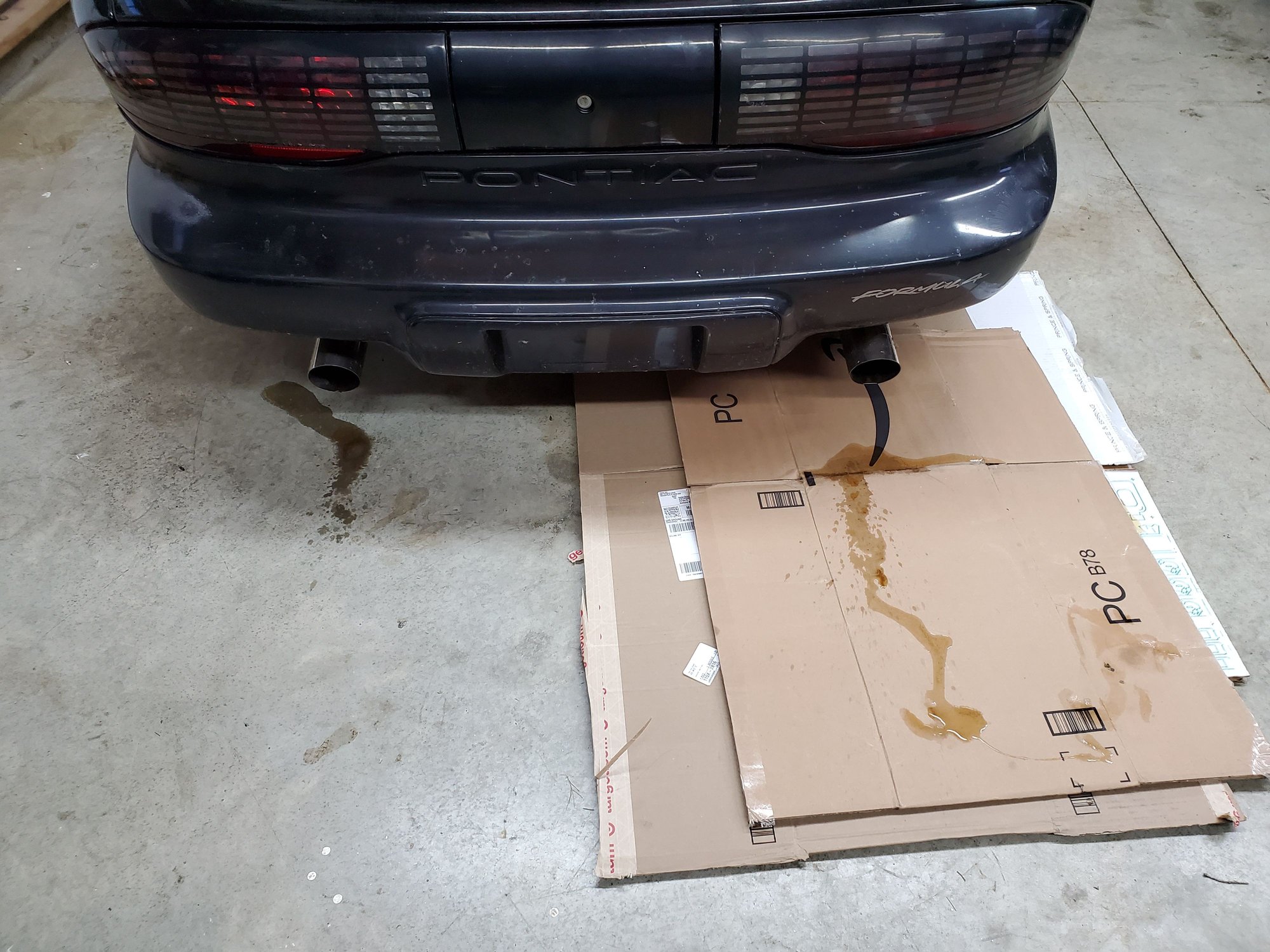

Is it normal for this much water to be coming out of my exhaust? I'm assuming it's from sitting for years without being driven.

Water is a byproduct of burning gasoline. Some condensation in the exhaust is normal, but mostly in cold weather. A few drips at startup in hot weather is normal. If you are starting the engine repeatedly for short periods without letting the exhaust system heat up, water will continue to build up. With the nose of the car in the air, it’s eventually going to run out the exhaust tips. If it was burning coolant due to a head gasket leak, the smoke might be on the white side and have a “sweet” smell. Your spark plug in the leaking cylinder would be exceptionally clean.
System looks sludged up, possibly creating hot spots that could boil the coolant when the cap is off, and no pressure in the system.

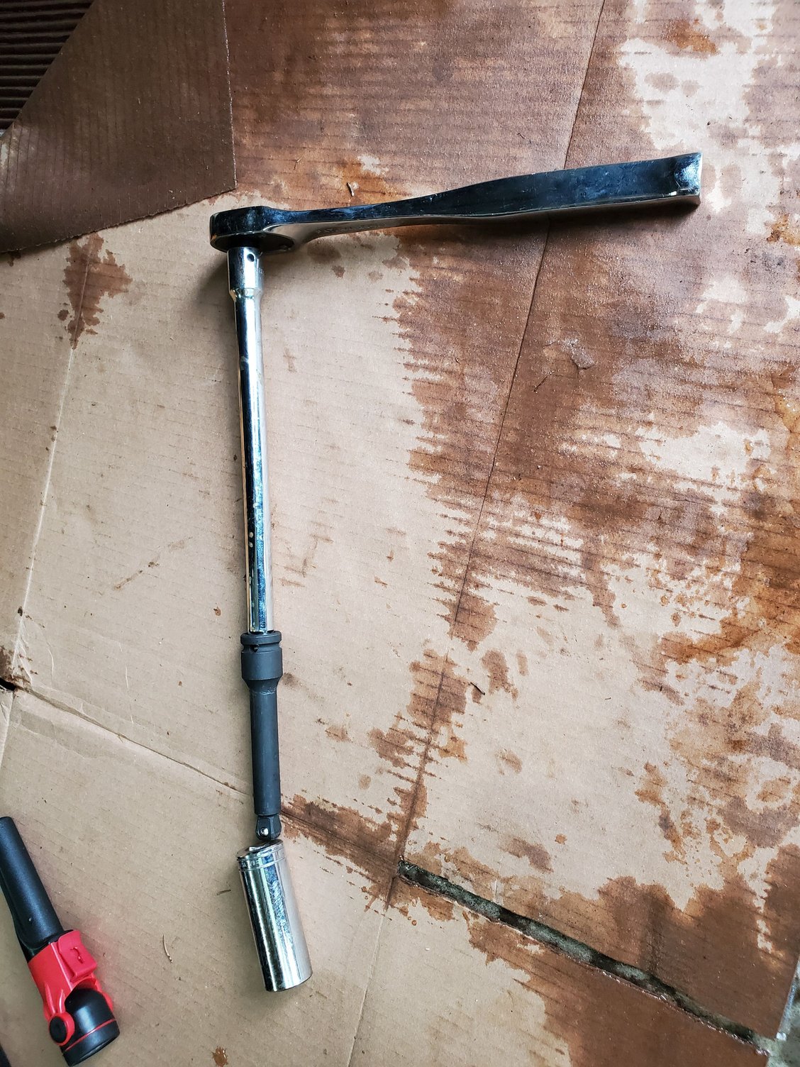

I eagerly removed the knock sensor on the passenger side. It came out very easily with a wobble extension, deep 7/8 socket, and 1/2 drive ratchet. I think it was removed before, as there is gobs of some kind of sealant where it mates to the block. The part that the wire harness connects into is wobbly. I'm going to replace it to be safe.

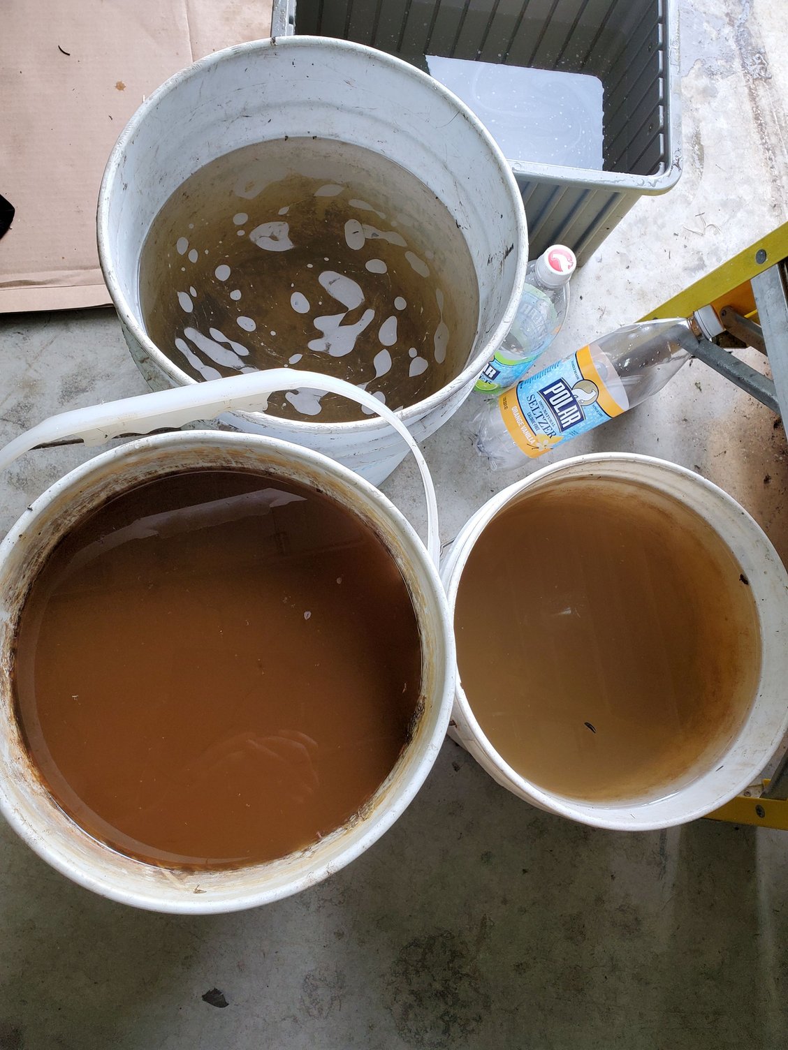

I ran lots and lots of water from a hose through the empty thermostat hole. I was able to attache a brass fitting that I had to the block, with a rubber hose on it, to more easily collect the old fluid. I wanted to see what it looks like as I progressed and I want to be able to dispose of it properly. As you can see from the images, the first bucket is very, very dirty. The rectangular gray bucket is what result I had before I turned the hose off to have lunch. I'm going to do it again once I am able to do the driver's side.
Since the car is at a steep angle, am I trapping sediment at the back of the block, or is the flow of the water carrying it out through the drain hole?
The plug on the driver's side is very difficult to access. I think I am going to have to drop the y-pipe, which I'm not looking forward to. I think someone did this before, because the images I have seen online show a raised plug in this location. What I have is one of those plugs that installs almost flush, with a recessed hex drive in it.
If I'm going to flush the system, I might as well be thorough, especially given what the coolant looks like that came out of the passenger side. How can that mud not be part of the problem that I am having? I mean, I guess we will find out.
I want to strain this stuff through something to see how much sediment is left behind. Might make for an interesting picture.

When you buy a new knock sensor - good idea - make sure it is the one for 93-95. They changed it to a sensor with a significantly higher resistance in 96/97, and they are not interchangeable.

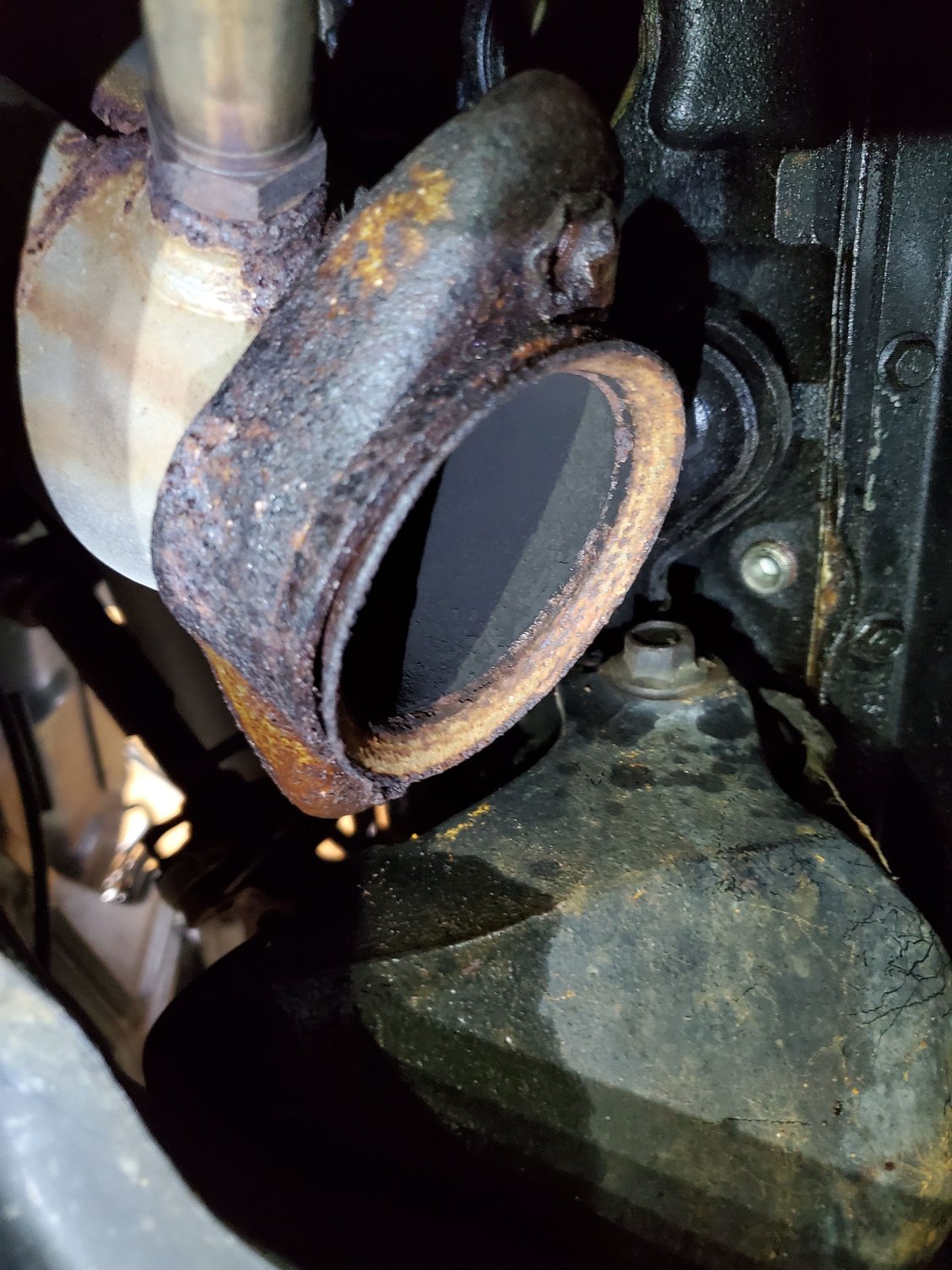

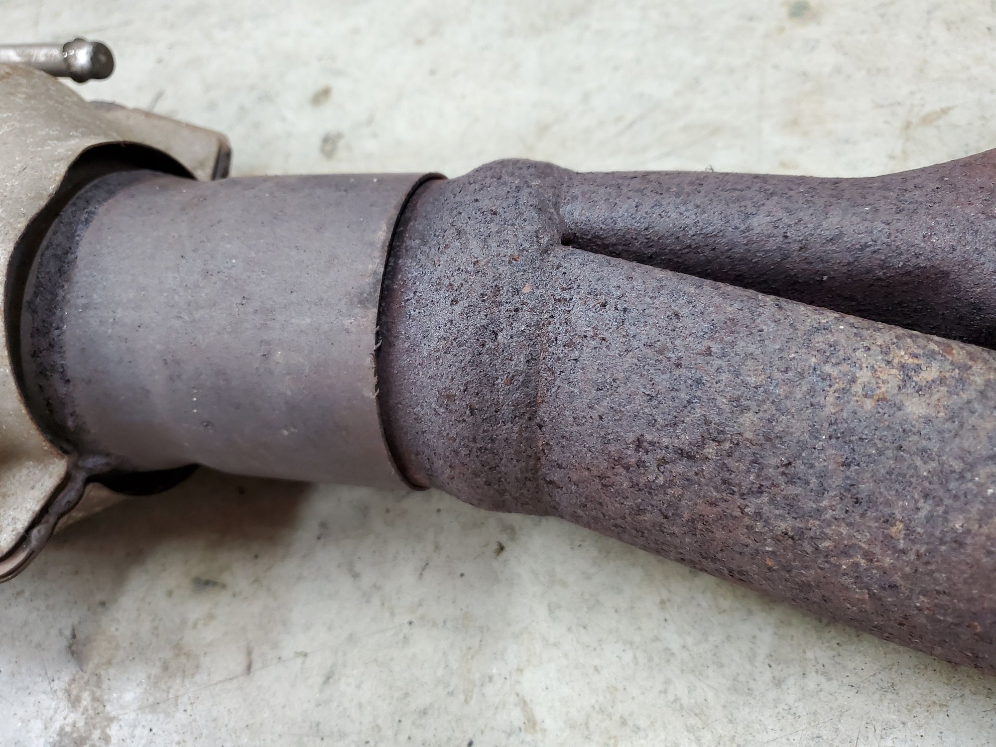

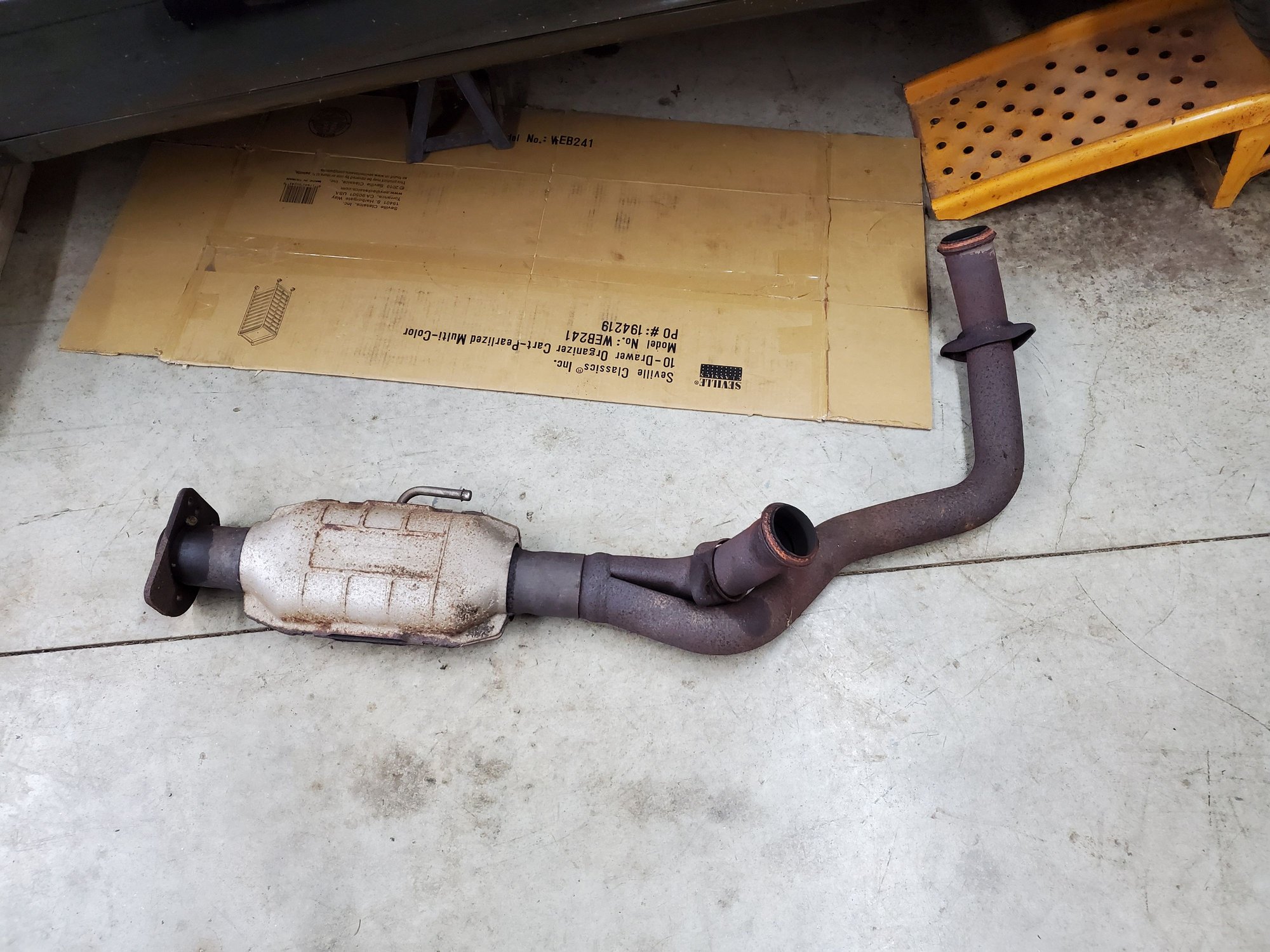

Shouldn't there be a clamp where the y-pipe enters the catalytic converter? Mine has no clamp and there is wiggle in the joint.

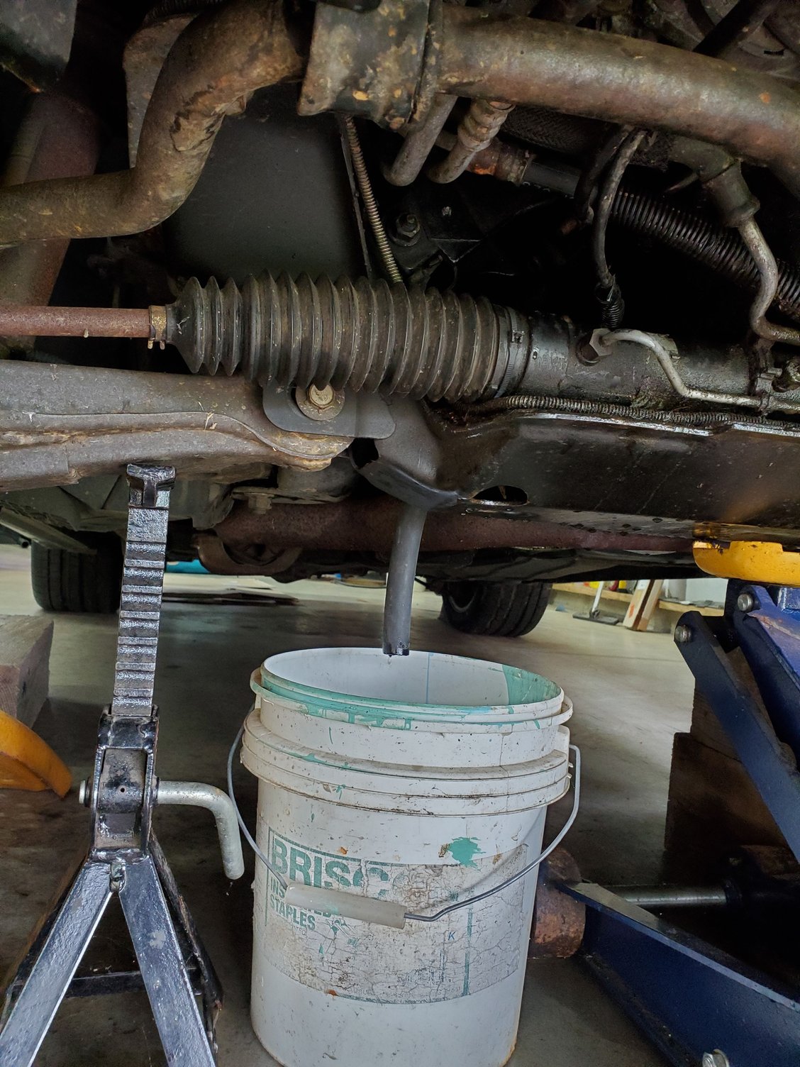

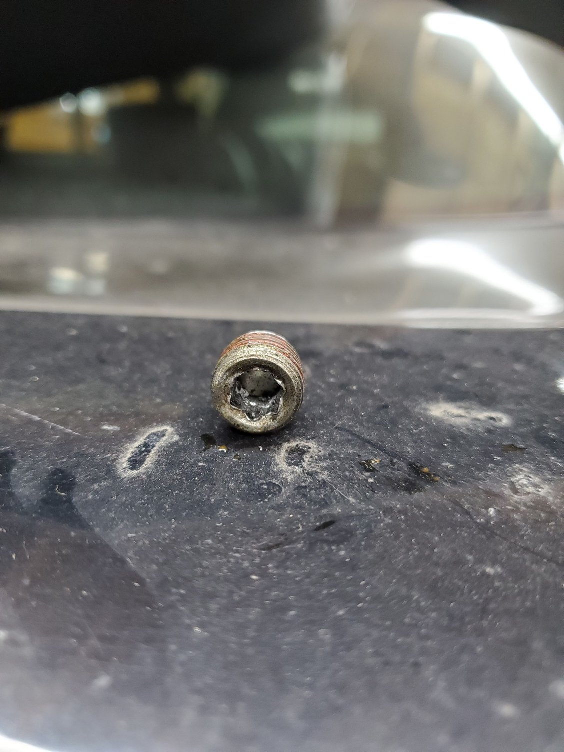

Once the y-pipe was off, I was able to get much better access to the block drain plug on the driver's side. Using a hex bit and ratchet, I could feel and see the bit start to turn without the plug moving; the hex head was going to strip and I knew that would create a high level of suckness. I knew an impact was my best hope. I tried my Cornwell 3/8 impact for a while but the plug would not budge. Used a 1/2-3/8 adapter to get my Earthquake involved and the plug came out immediately.
The coolant that drained out of the hole is pretty dirty, but not as dirty as what I removed yesterday. I hope to have time to flush this side thoroughly tomorrow.

Somebody changed the cat. It’s not the correct one. When it left the factory, the cat was welded to the Y-pipe. It has been cut off, and replaced with a 2-bed+AIR converter used on pre-1993 models. The pipe sticking into the side of the converter connects to the secondary air (AIR) pump on the pre-93 models. The older models ran air into the manifolds on startup, then diverted the air flow to the cat to oxidize unburned HC and CO. The 93 and up system does not work like that. The AIR pump runs for 3-4 minutes at cold startup, then shuts off. The cat does not need the extra air injected in front of the second bed.

Is there any need to change this cat even if it' not the correct type? The AIR pipe on it looks to be capped and the AIR system on the car has actually bee removed. I was just thinking of adding a clamp where the is none to prevent leaks.
