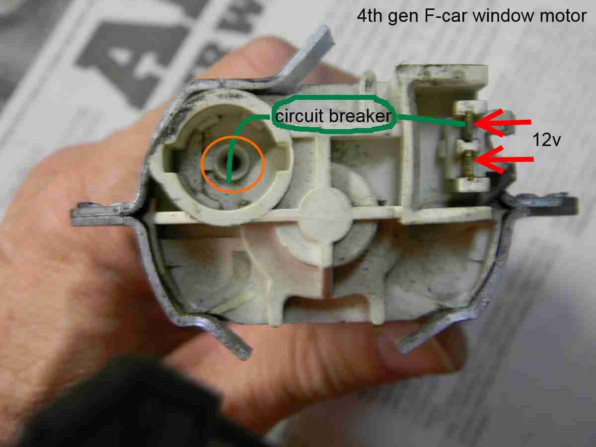

If there is 12v difference for the two wires at the motor, then the motor is defective (of course). The most likely cause is a defective circuit breaker inside the motor or an open circuit at the motor brushes. You can reach the motor internal circuit breaker output by probing with a sharp tool (nail?) through a hole (inside orange circle) in the end of the motor. The green shows the circuit breaker and internal conductors underneath the white plastic end piece. Jumper the wire shown at the upper right to the nail in the hole to bypass the breaker and energize the motor, If this does not work, the brushes or windings are open. This is only a temporary fix to get the window up.
