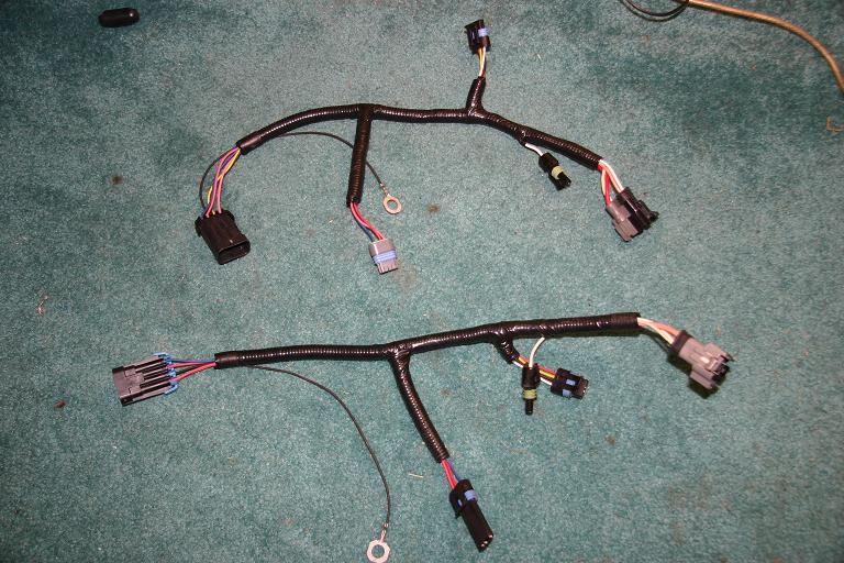

I have a accel DFI on mine, Im just going to run a MSD Opti, I never really had problems with even the stock ones, I had one go bad in the 7 years I had my car and that was only due to a leaking WP. the accel unit for the LT1 comes with the opti harness, hell it came with both styles of them old non vented and new vented plugs., I was really suprised whe nthe kit came to see 2 diffrent harness's for the ignition, the harness has the coil plugs and opti plug all in one thing so its not like its just one diffrent end its a harness.
