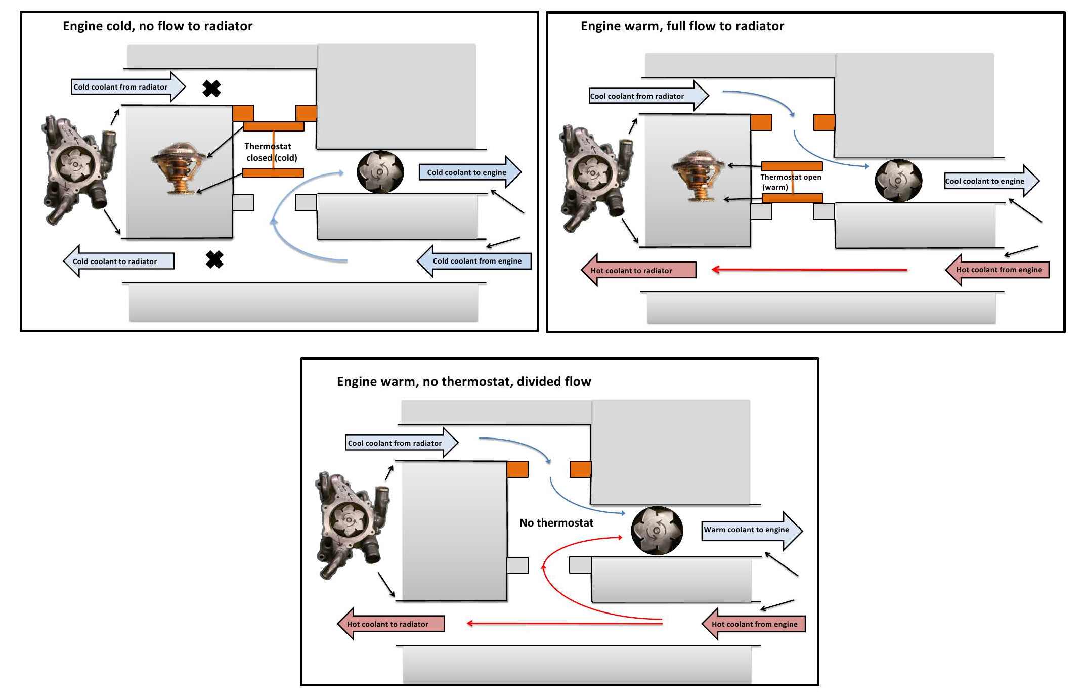

Originally Posted by mzgp5x
App... 97 MM6 383/ F1A. BeCool with Evans cooling, Meze pump 53gpm, High flow fans. No themostat. ByPass circuit blocked.
uns @ 160*F or less.
B.
It's not a good idea to run with no thermostat because that allows some of the coolant to flow back into the engine instead of to the radiator. That may have been the cause of some of the overheating issues.
