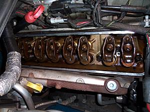

Before you give up on the Opti, check the harness connectors (gray one in the picture, and the one directly at the Opti) for corrosion and damaged pins. And push the gray Opti connector pushpin into the hole in the bracket next to it, holding the EVAP solenoid. That's where it belongs. You don't want random RFI from plug wires interfering with the Opti signals.

Thanks. Where do you exactly mean to push opti connector pushpin into? Which bracket are you referring to? Turns out it is the opti. The harness connectors were clean. So now I'm really leaning towards doing the full conversion, unfortunately more money but I think it will save me in the long run.

See in this picture the the gray colored connector with a push pin is inserted into the EVAP bracket. I believe this is what Injuneer is referring to.
You might have to click on the photo to enlarge it.
