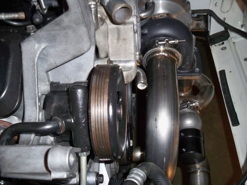

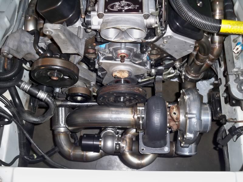

Jon has gone WAY above and beyond for me on this setup. I can't tell you how happy I've been with the fit of this setup now that I have it all mocked up.
I had a VERY specific layout in mind that Jon was able to 100% provide. In fact, he was able to give me even MORE features that I had hoped for! The only thing I was willing to get rid of was my A/C.
My criteria:
-Front mount turbo setup with 1 3/4" forward-facing stainless headers.
-Passengers side downpipe exit through the K-frame for zero loss of ground clearance.
-Retain ALL stock accessories in stock location (K-frame, motor mounts, ABS, accessory bracket, alternator, etc...).
-No cutting of the radiator support and mounting the radiator vertical
-Wastegate plumbed back into downpipe.
What Jon delivered:
-Passengers side downpipe exit through the K-frame. I have a minimum of 3/4" of clearance at every point through the K-frame/motor mount/engine block with the exception of one area next to back edge of the K-frame (which still is just under 3/8"...plenty). I was amazed at how perfectly this pipe fit in the such a tight space with not even a single area of "clearancing" required.
-ALL of the stock accessories in the stock location have been maintained. It was very important to me not to have to cut up my low mileage SS for this build. I have not had to move anything. The body harness, cruise control cable, waterpump, tensioner, accessory bracket, radiator hoses.....nothing had to be removed or even relocated. The only thing I had to do was rotate one of the waterpump housing ports about 30 degrees, but I am still able to use the same hose.
-Jon was able to position the turbo so that I could even use my large BeCool radiator in the stock position (not even having to "pull" it forward any)! I have plenty of room for the pusher fan setup. There is almost enough room to run a thin puller fan if I wanted to! There is a full 2" of clearance between my radiator and the exhaust housing of the turbo.
-Jon plumbed the wastegate in a position where it didn't take up any "extra" room in the engine bay. It's mounted between the downpipe and right side crossover and runs nicely back into the downpipe.
-Plug access! This was one of our main concerns at the start, specifically on the drivers side. After 4 "revisions" to the drivers side header (most people wouldn't put that much effort in), he was able to provide me with headers that have plenty of plug access. In fact, I can do all the plugs from the top of the car in less than 20 minutes (both sides)!
I've seen quite a few "professional" LT1/LS1 turbo fabrications over the years. All but a couple of them were sub-par in my opinion. Jon (although he humbly admits to being an "amateur" ) has really developed his skills over the years helping us LT1 guys with turbo kits. In fact, I am confident enough to say now that I highly doubt I would be able to have executed a setup like this with a "professional" fabricator for any reasonable amount of money. Even then, I have seen significantly worse fabrication skills with some of these "professionals".
Jon, thanks buddy for all the help on this!!!

Looks like art made out of plumbing guys<Dave claps loudly> Love the welding quality as much as the routing. I'd love to see a machine that could duplicate that setup. It would only cost a million dollars or so
