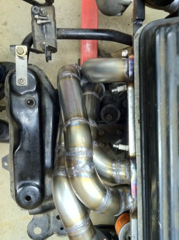

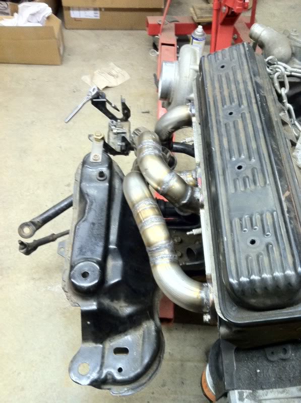

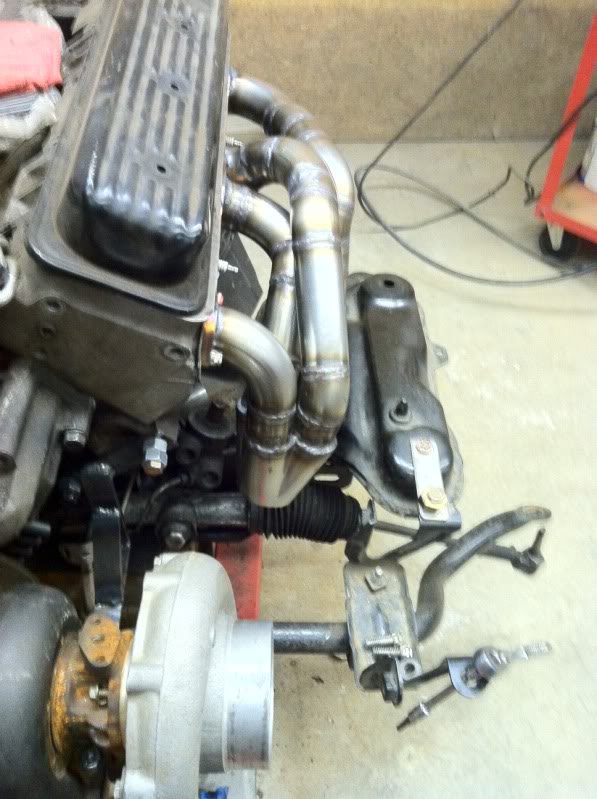

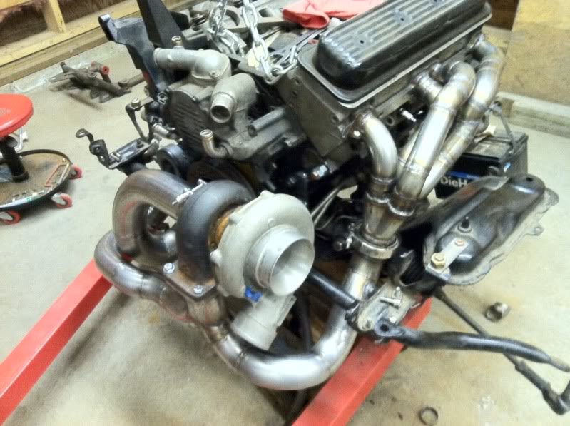

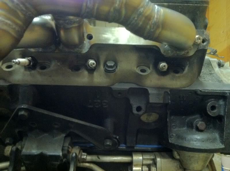

Unbelieveable Jon! I can't believe how well that drivers side header turned out! That is exactly what I had in mind, and initially I thought that I would have to sacrifice plug clearance on that side due to my header style and routing criteria. The plug access you were able to get out of it is just incredible!!
You've exceeded my expectations

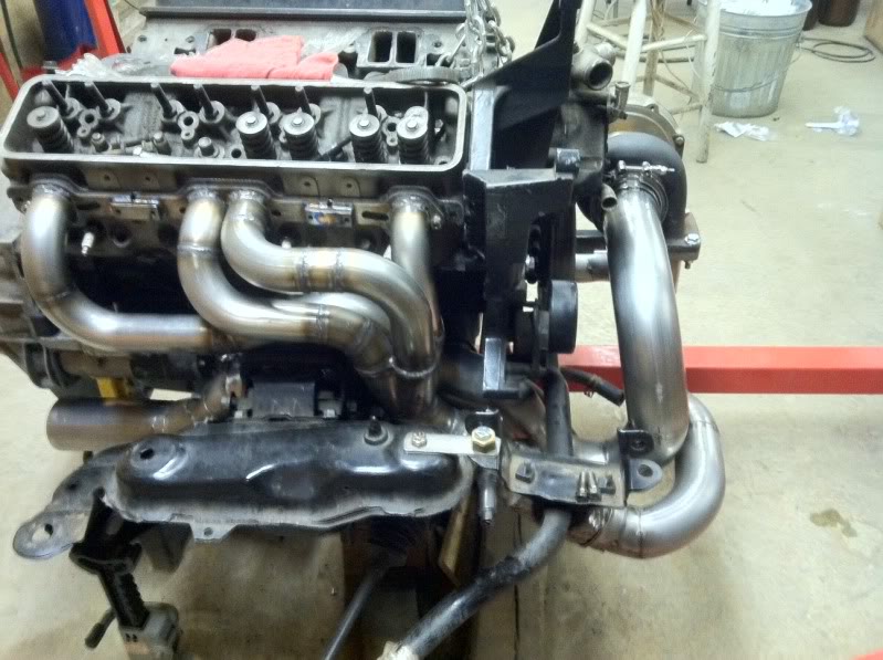

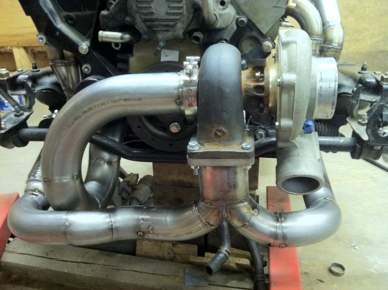

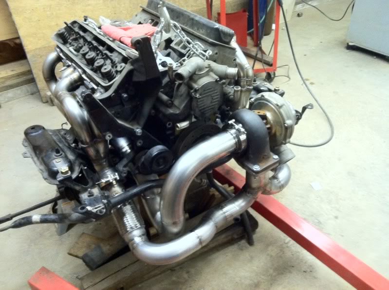

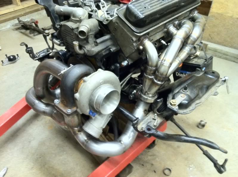

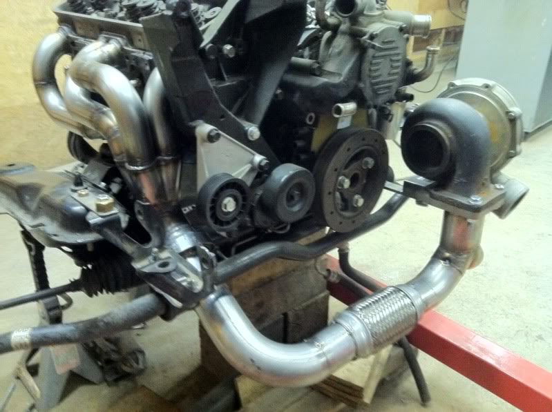

Changed the crossover a little, and need to make one tweak to the DP, but here is the initial mockup.

Jon, you are really moving fast with the fabrication!! Again, the setup has already exceeded my high expectations
I am going to run a Tial 44mm or 50mm wastegate. Also, I have the Canton pan for LT1 F-bodies on my car.

JGS 50mm gate and call it a day. Plus i have one I can use for mockup

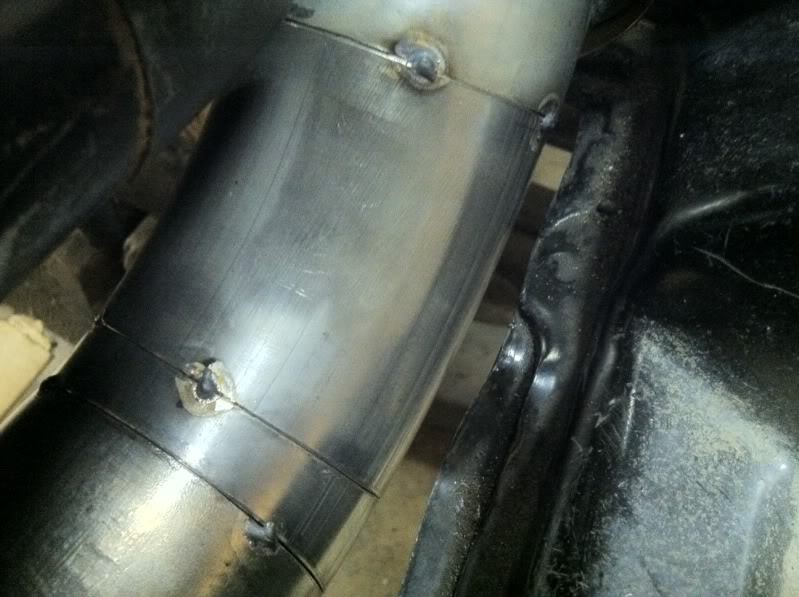

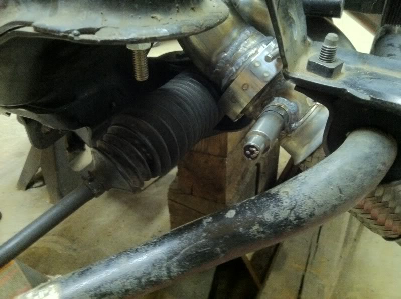

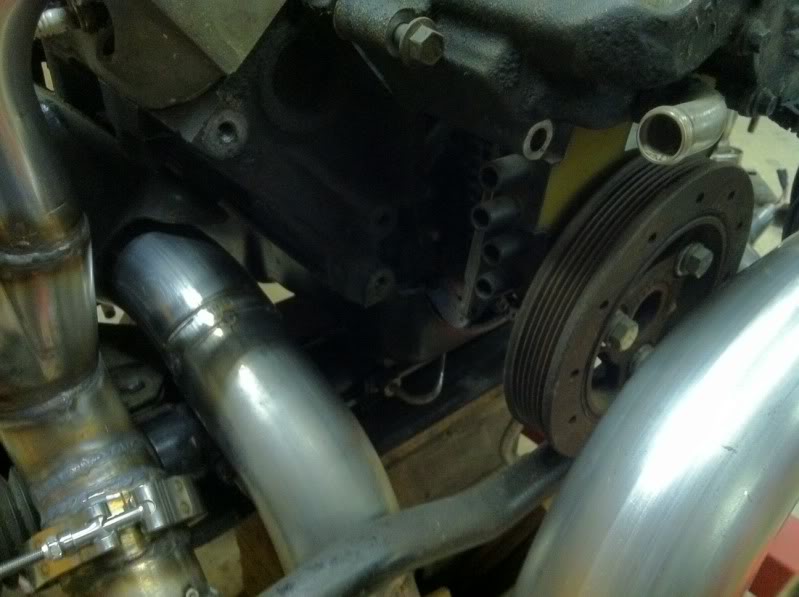

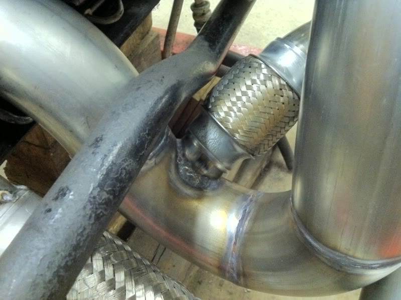

Clearance of short downpipe piece next to pass side k member:

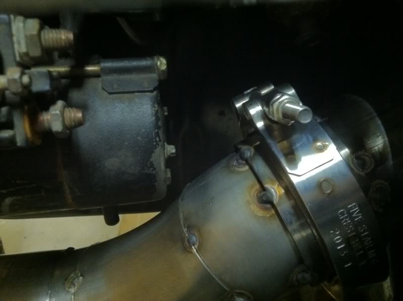

Clearance of DP near starter. I had to route it here due to jason running a canton oil pan.

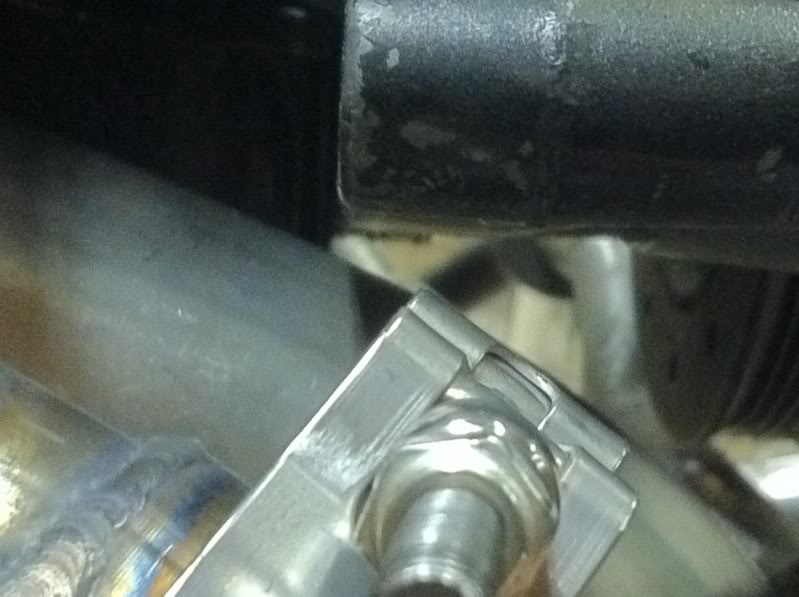

Clearance of DP under accessory bracket

Clearance between DP and crossover

Jon,
I can't tell you (again) how happy I am with how it turned out You've exceeded my already high expectations!! Every setup I've looked into (or owned) involved sacrificing something. Aside from the A/C (which I didn't want or need), I can truly say that I have not had to sacrifice anything with this setup

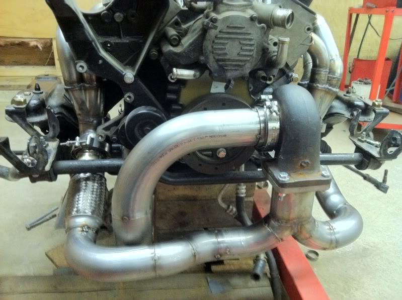

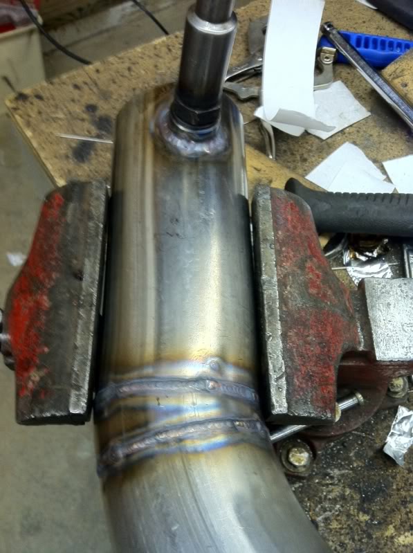

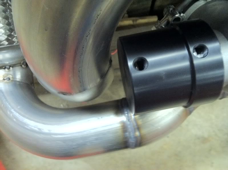

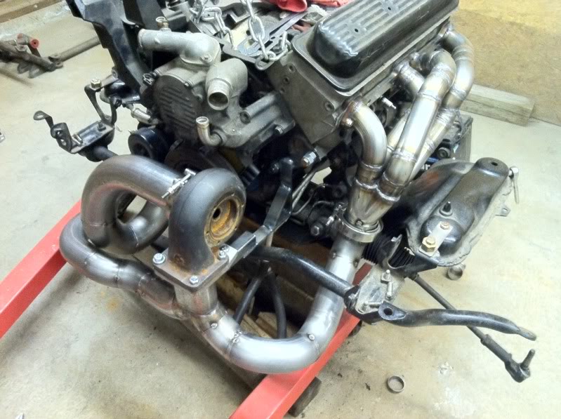

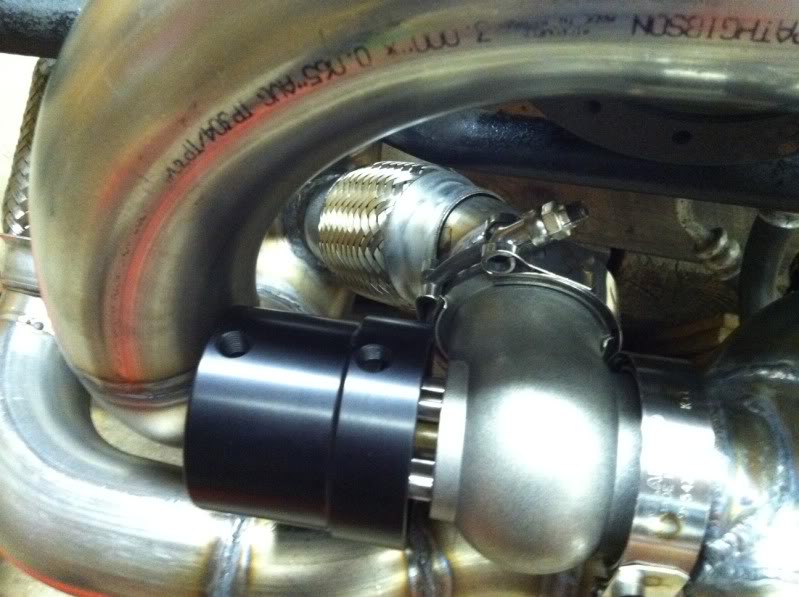

Thanks guys. Twin feed pipes for the 50mm wastegate. You can see the start of the dump pipe for the downpipe

Old Jan 1, 2012 | 08:59 PM
RealQuick's Avatar
Joined: Feb 2002
Posts: 5,645
From: Bridgewater, MA
Re: Turbo Build For Jason Short

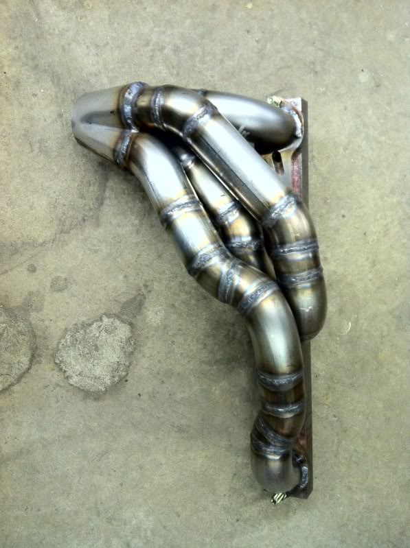

downpipes welded

Jon, this setup is looking crazier by the day! I just tried sending you a PM, but your box is full.
I can't believe how this is turning out. You have gone WAY above and beyond for me on this!!
Holy cow and I thought my routing was intense!
Just as a thought, would going to the gear-reduction LT4 starter get a little more clearance in there?
Hey Geoff, yeah the LT4 starter should help with clearance. What's up with your car?
