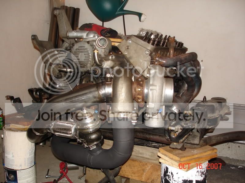

The turbo should have been high enough for gravity drain:

Jon, that looks like a good design. The turbo is 'flipped' compared to my design I bought from you. Does this design shown here require the standup radiator or other deletions?
Old Jun 6, 2008 | 09:58 PM
  #22
97s10ondubs's Avatar
Joined: Mar 2004
Posts: 1,109
From: Davie, FL
Besides a/c no, but the fans can be moved to the front of the radiator w/o having to cut the rad support, that what i did and it doesnt get hot at all w/ the pusher fans. Jon it looks like it should drain, but it's really not that big of a difference in the car, it's only a couple inches higher and i didnt want to use 90* fittings b/c i was worried about flow problems, by the time the hose bends it goes under the drain bung and back up to the drain. It's fine for a few minutes of idle, then the smoke show begins and oil leaks out from the exhaust side of the turbo and some of the clamps in the exhaust, barely any in the intake side.
