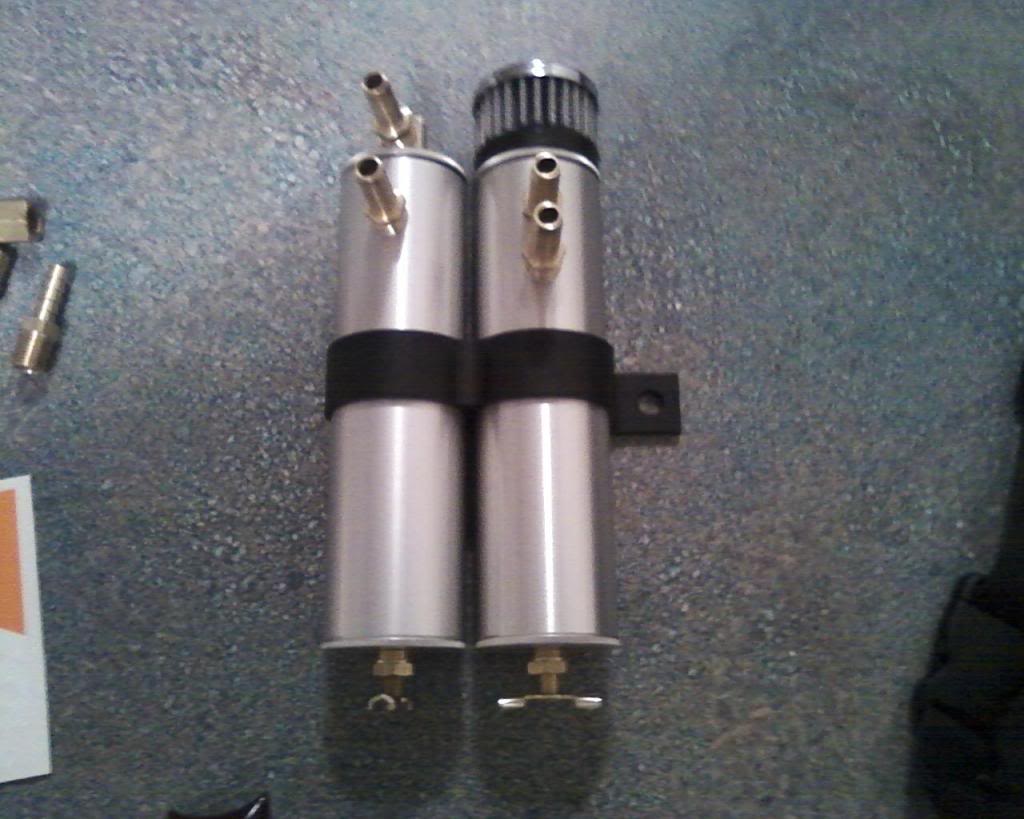

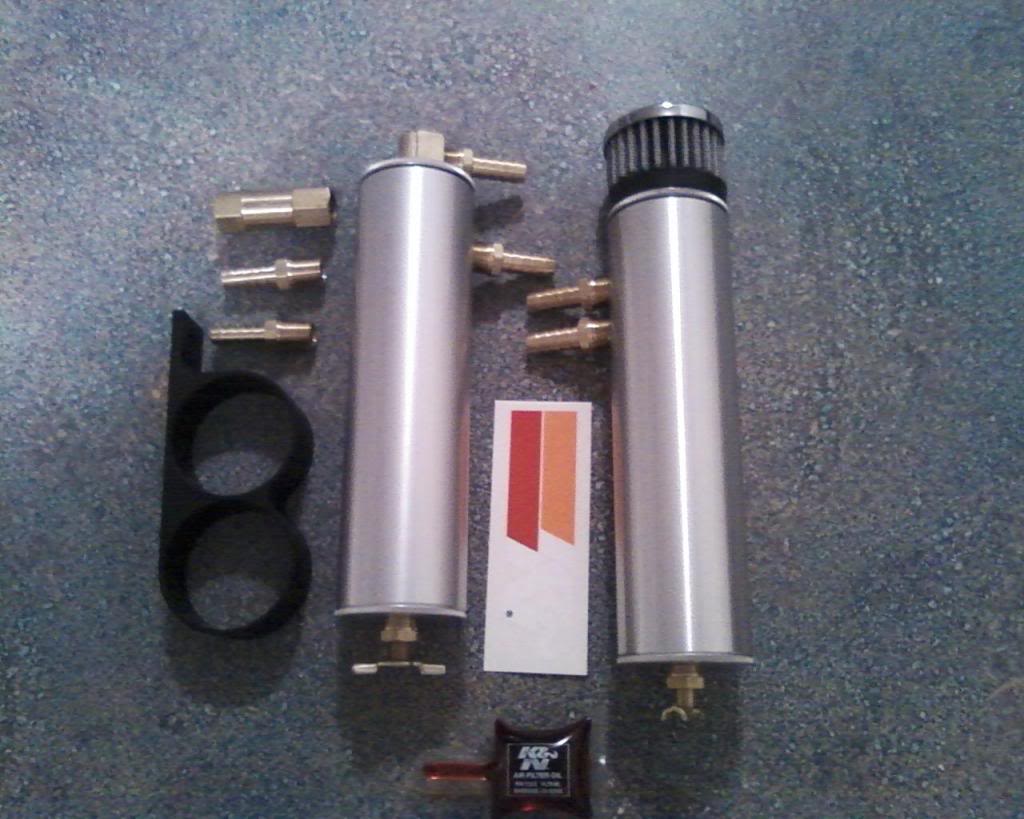

I would run this , the custom duel catch can system fixes PCV issues, it fixed both my Procharged cars
