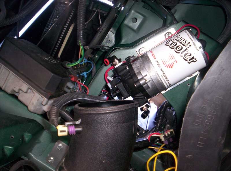

I stuck mine under the area where the fuse box/air box is - not in the engine compartment behind the headlight, but underneath there mounted upside down. Then I used the windshield wiper resevoir for the meth/water

thanks kevin blown 95 that spot worked perfectly!
