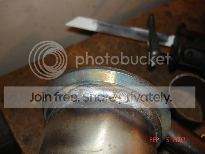

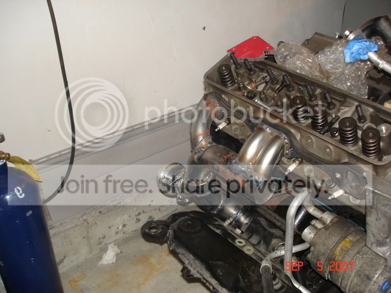

Here are some pics of a log manifold setup i am making for someone. He will be running a forged shortblock with stock heads/cam for now and TH400 combo. Here are some specs and progress pics:
1.75" primaries
2.5" pas. manifold with 2.5" crossover
44mm Tial style wastegate
3" main log
3" DP
Mild steel mig welded

Realquick, I think you need to try and fit a 3.5" downpipe and let me know how it turns out.
Mike, with the stock k-member on the mockup, there is no way it would fit IMO. Now, I have a tubular k in my car and took some measurements... looks like a 4" would fit

From: Baton Rouge, LA, USA
Looks like fitting it past the steering turnbuckle would be my first issue, then fitting it between the crossover pipe and the frame rail is the second. And that's on a 3.5". . .
Mike
Stock or aftermarket K?
BMR aftermarket.
Mine fits with the downpipe passing through the same area. Mine has a tubular K-member, though.

From: Brockton, Ma
Do you think a 3.5" would fit through there if you ovalized it?
