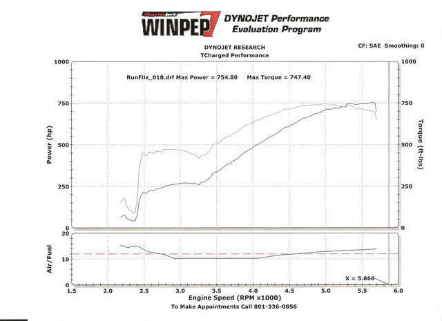

Old Oct 25, 2008 | 11:14 PM
  #21
Funkybird's Avatar
Joined: Jan 2006
Posts: 216
From: Utah
Update: Just got home from the dyno. I messed with the tune a little bit and I was able to pick up 100 more hp. The bad news is its still running out of fuel and the fueling tables are maxed. I have reached the limits of the stock pcm it seems.
This is on 91 octane.

Old Oct 26, 2008 | 01:37 PM
  #22
97WS6Pilot's Avatar
Joined: Apr 2005
Posts: 1,546
From: Florence, Kentucky
That is a bad *** torque curve. Nice job. You are making 750hp at 5500 rpm if I'm reading it right. Long live the F1A!!!! What pulley combo are you using?
Old Oct 26, 2008 | 03:10 PM
  #23
Funkybird's Avatar
Joined: Jan 2006
Posts: 216
From: Utah
I'm running 3.40/7.65 I really need to figure out my fueling issue so I can see the full potential!
Old Oct 26, 2008 | 06:17 PM
  #24
97WS6Pilot's Avatar
Joined: Apr 2005
Posts: 1,546
Are you running a methanol kit? That would probably give you the additional fuel you need. Are you sure you are not getting belt slip?
Steve
Old Oct 26, 2008 | 06:52 PM
  #25
Funkybird's Avatar
Joined: Jan 2006
Posts: 216
From: Utah
I have an AIS stage 2 kit running 100% meth. I don't think the belt is slipping, boost comes on linear and holds and there isn't any belt dust anywhere.
Old Oct 26, 2008 | 07:31 PM
  #26
roguedriver's Avatar
Joined: Oct 2002
Posts: 1,194
From: Albuquerque, NM.
IMHO, your running out of fuel line now. Your PCM will fuel the daylights out of that thing assuming you have the volume to go along with it. The parallel dual pumps will get you there, but at that HP level (flywheel), trying to push that volume through a small line with a series rail setup isn't gonna work too well. Upping to an -8 AN line and paralleling the rails will give you tons of fuel, and i would guess at that point you'll be pulling all kinds of fuel back out of your PE tables. Just really quick though, you do have a good new fuel filter on it, right?
Ken R.
Old Oct 26, 2008 | 08:58 PM
  #27
Guitarman03's Avatar
Joined: Jan 2008
Posts: 24
Have you tried to scale your injector flow rate by 10% and then also Scale your VE tables so you then have 10% more room on top to add fuel? With the 2Bar setup I've been using I've done this a couple of times (E85 needs LOTS of fuel) and it works pretty good.
Old Oct 27, 2008 | 05:18 PM
  #28
Funkybird's Avatar
Joined: Jan 2006
Posts: 216
From: Utah
Looks like my next purchase is going to have to be some bigger lines then. I put a new fuel filter on when I did the pumps earlier this summer.
I didn't change anything in the tune other than the PE table, I am very new to tuning.

Old Oct 27, 2008 | 08:45 PM
  #30
97sstroker's Avatar
Joined: Sep 2008
Posts: 15
From: West Texas
my t-trimed 383 making only 600rwhp was having fuel and tunning issues until I put larger lines. I went from the tank with a gravity feed into an aeromotive pump to the front then into some custom rails into an aeromotive fpr and used the stock fuel line as a return. I also disabled the stock fuel pump but left it in the tank so my gauge would still work. Just because you have the fuel pressure doesn't mean you have the volume so safely operate at that kind of hp.
