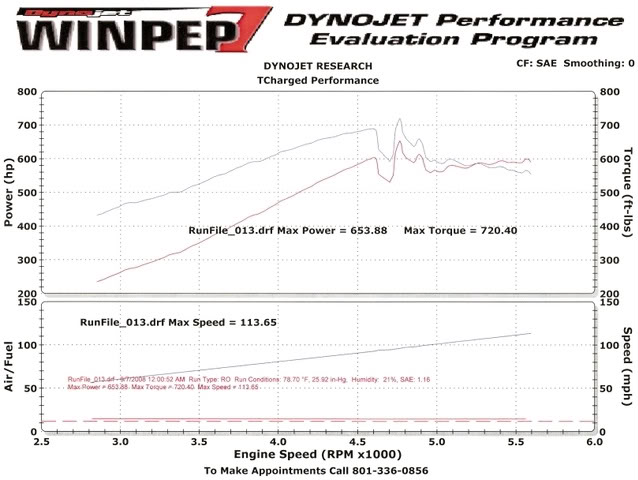

Chuck from HPE came out to Utah yesterday to do a group tune. My computer is pretty much maxed out at 4600 rpms so we couldn't run it up any higher but here are the results.

very nice, so you need a new pcm and then a new tune ? How much boost ?

Thats what it sounds like. Its hitting about 13psi when its freakin out at 4600 but we did run it up to 6 grand and it was 18-19psi.

Thats not your computer causing that. You need to look elsewhere. I'd be really concerned about spark blow out. Thats kinda what that looks like. You also didn't say what your A/F was and it's hard to figure it out on your dyno chart, but if thats your true A/F read out, you definitly don't want it going up through your pull. That means your not adding enough fuel in your tune, or your out of fuel system and not supplying enough. Never the less, look elsewhere besides your computer. There's plenty of guys out there making more power then that with the factory pcm. Hope the info helps ya out. Has the potential to make good power all the way though.

Boost is climbing upwards of about 13psi when the graph goes crazy but the few times he took it to 6000 it got up to 18-19psi.
How do you determine the spark blowing out? He had the wideband for the dyno hooked into all his stuff he was tuning with so I don't know exactly what it was at. He said its still pretty fat up until the graph freaks out then it goes really rich then spikes to lean. We hooked up a fuel pressure guage and pressure was holding fine.
He made 14 pulls trying to fix it and he said the VE and power enrichment tables are maxed out and he can't add anything more at that point and he said its pretty much at the limits of the stock pcm?

Unless you've already done it, by gapping the plugs to .032 and seeing if that dip goes away. What is your current gap? Are your springs spec'd out to work with that PSI? Some guys are running enough psi that the valves won't stay closed because their valve springs aren't strong enough. Great numbers considering it's a 'tainted' run! I didn't know Chuck tuned LT1's .

For the plugs, your gap is good. A lot run the TR6's here, but i prefer a non-projected tip plug. I had spark blow out even though i was running a .030 gap, but a projected tip plug. Got rid of it by just swapping to a non-projected tip plug. I usually run the NGK BR7EF's or Autolite AR47x, with the x being the heat range.
.525 is not a lot for max lift. What cam and rocker ratio are you running? You also need to know that A/F ratio. Although the pressure holding steady isn't a bad thing, pressure kinda means nothing in an application like yours. You can have pressure holding, but you may not have enough fuel volume to support the power. You should also have a boost referenced regulator on your setup too. That way, fuel pressure will step up when boost steps up.
As far as the tune maxing out, if your running a MAF setup (are you or speed density), then MAF readings will max out under that much boost. Doesn't mean that you can't continue to add fuel by RPM. Now if he's maxing out the PE tables to try and get you more fuel, then that means your out of fuel system and the engine isn't getting enough fuel, in which case, it would be time to upgrade. With your numbers, i'd say you should be looking at a dual high volume 255 in tank setup if you don't have that already, and paralleling your fuel rails would also help greatly. Larger fuel lines would also be an improvement and give you plenty of room to grow if you choose down the road. 60lb an hour high Z injectors at a minimum would be needed as well although Racetronix is making a 72hr high Z now i believe which would be even better.

For the first few pulls we were running with the maf but he switched it over to speed density to try and fix the problem but never could.
I am running dual walbro's and 60lb/hr injectors and stock lines, regulator and rails.

Without raining on your parade of problems, just want to say those are some nice numbers 650/720 with more left in the LTx

What does tire spin look like on a dyno chart?
How does the car drive? Do you believe the graph?
How does the wideband look?
Just a question here, but PE tables maxed beyond 650HP@4600rpm. Somebody please tell me that fuel is not the problem. What are you running for spark?

Thanks guys! I don't know how to spot tire spin on a graph? I got on the car on the street but only ran it up to 4 grand and it felt incredible!

Do you know what the seat and full lift spring pressures are supposed to be and at what installed height? Maybe it is only wheel spin like he said. If you're fuel pressure is stable and high enough, it doesn't seem like you're running out of fuel. Dunno. Our 60 pounders are supposed to be good to 600ish at 85% duty cycle but I don't know if that's at the crank or at the wheel.
In the end, as long as it's safe, engine wise, and you're having fun, the dyno numbers don't really mean that much. So many things can affect those numbers. I wish you and I were geographically close. It sounds like it would be a fun race between us.
