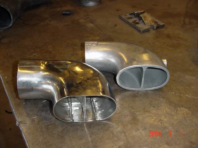

Also have a 58mmtb, Big F1 air filter, Homade intake elbow http://home.koping.net/u3243a/images...s/DSC01582.JPG much bigger ID than the one ATI sendt (had smaller area than my 58mmtb) a friend of mine modified the twin Ic for better flow/cooling (center the inlet on them).

P.S. Nice homeade elbow
