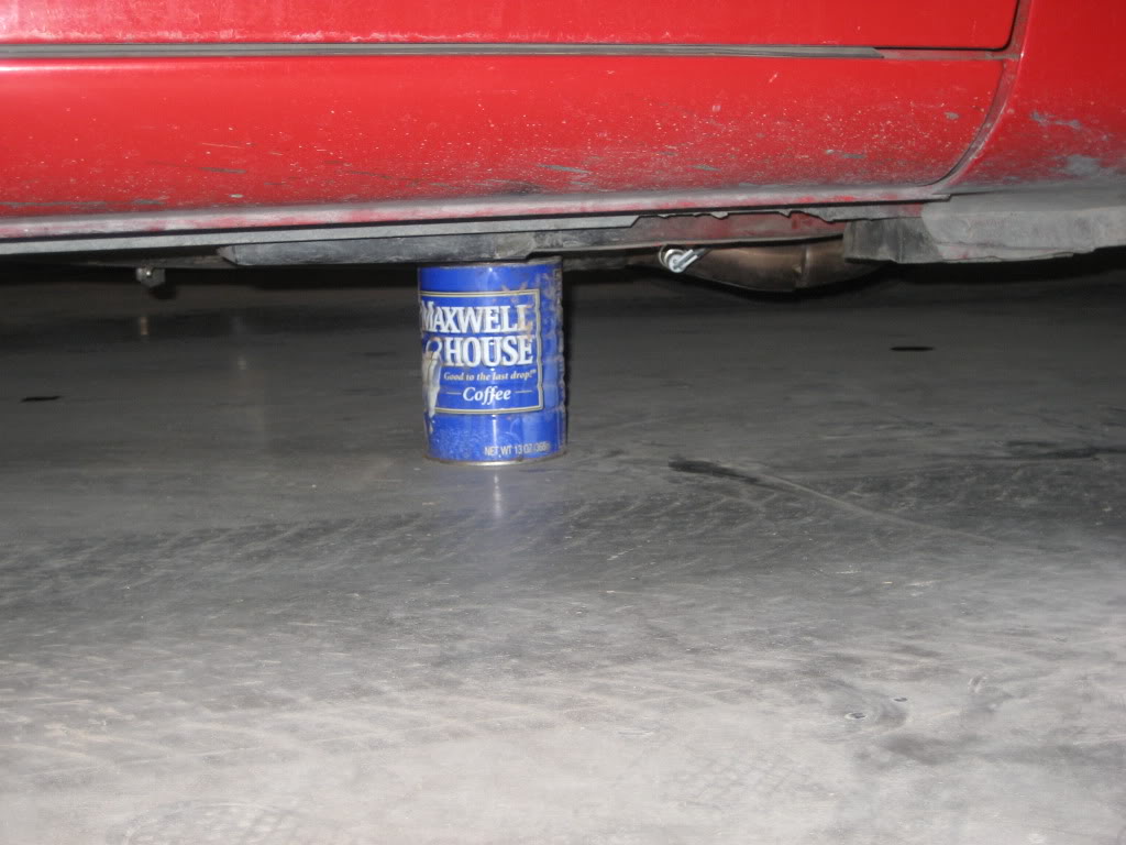

Do you think you could do me a favor and take a picture of the underside of the car to give me an idea of how the ground clearance is?
It sounds like you had a lot of issues they may not be worth it.

I'll try to get them for you. tonight. I have never posted photos here so it may take me a bit to figure it out.

I can't figure out a quick way to post photos, even went through the FAQ's but cannot find the attach button. PM me your e-mail and I'll go that route.

http://s1036.photobucket.com/albums/...ed93z/headers/
maybe this link will work.
Size:  98.2 KBhttp://i1036.photobucket.com/albums/a445/nmred93z/headers/IMG_2330.jpg http://i1036.photobucket.com/albums/...s/IMG_2328.jpg http://i1036.photobucket.com/albums/...s/IMG_2331.jpg

Aside from the fitment issues you had under the hood, the fitment looks great underneath the car.
It actually sits closer to the underbody than my Mac Y pipe.
