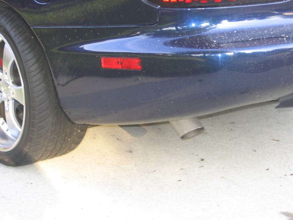

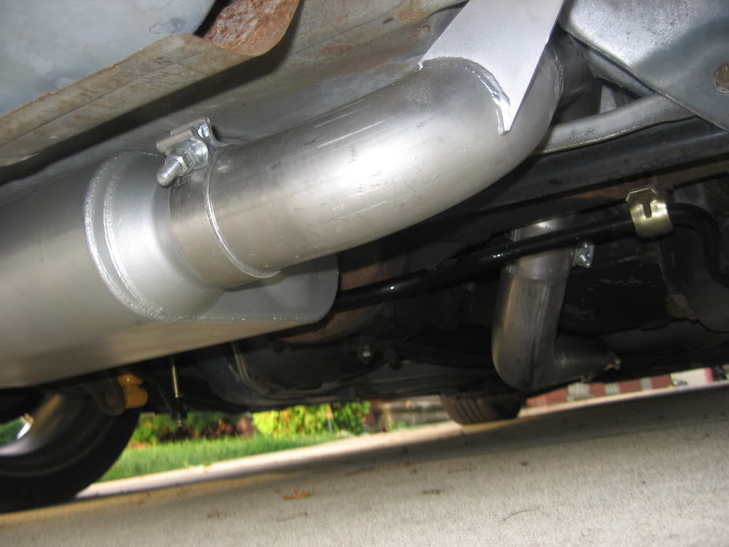

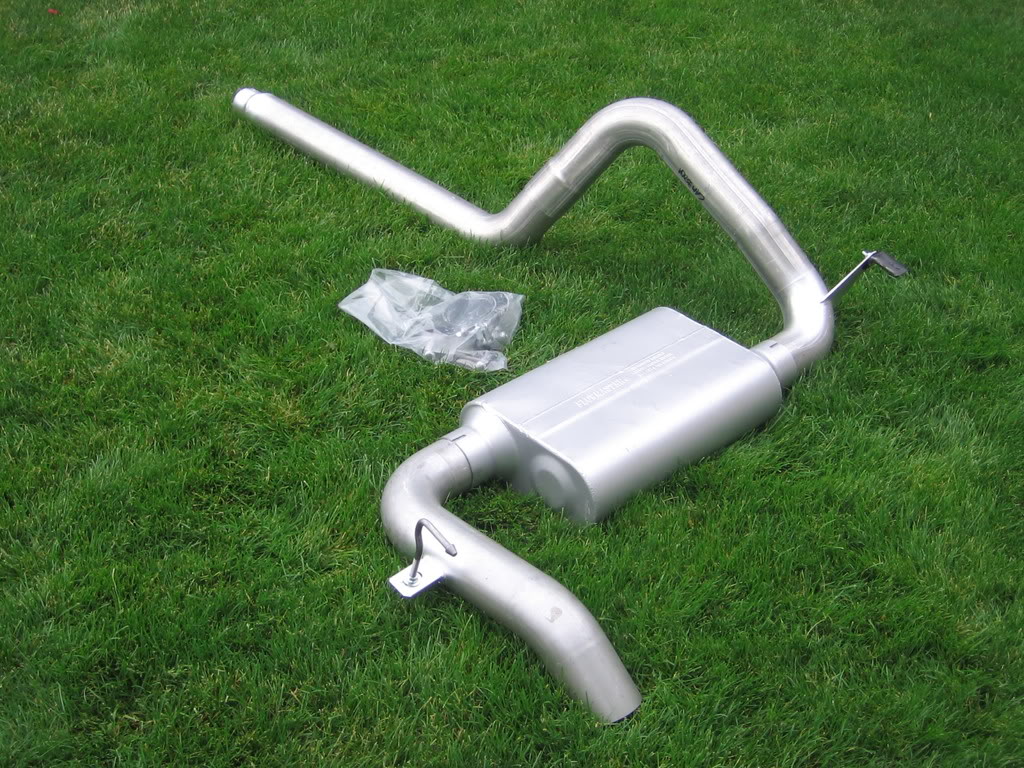

I have the 3.5" Single on the left system with the Flowmaster 30 series Race Muffler.
It has a much deeper tone then my old 3" SOTL setup.
Installation was pretty straight forward but required a little fabrication work to eliminate all rattles esp. the over the axle pipe.
Heres a couple pics taken directly after install.
System has since been modified and tucked up even more.
