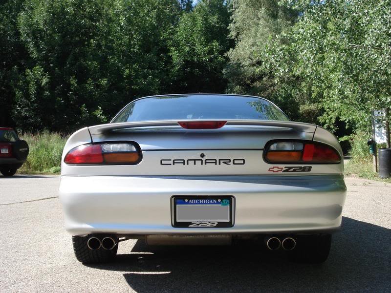

I did exactly what you're planning on doing, except I bought the non-polished 12267 Magnaflow. The muffler will fit on the stock over axle pipe and the outlet pipes fit the muffler fine, but the tips may be a little off if you use the stock outlet pipes, like this:
Since you're going with the stock tips which have an offset, you may not have the same problem. Even so, my local muffler shop offered to make new outlet pipes for only about $20.
As far as performance, it's my understanding that the bottleneck in the stock exhaust is the muffler, not so much the piping, especially since the stock pipes are 2.75" diameter and the Magnaflow catback is 3". As far as sound, it sounds just the clips posted for the LT1 catback.
