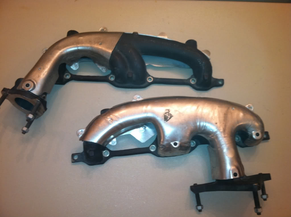

I've got a pair of those manifolds laying in my garage, I'll try to get you some pics up after church.

Old Feb 27, 2011 | 04:04 PM

Re: LT4 exhaust manifolds in a 94 car, emissions problems?

Old Feb 28, 2011 | 07:08 PM
Posts: 71,109
Appears they have the connections for the AIR pipes and for the EGR.
Old Feb 28, 2011 | 10:33 PM
Gtpguy's Avatar
Joined: Sep 2003
Posts: 860
From: Seattle
I saw that too. That answers my question.
