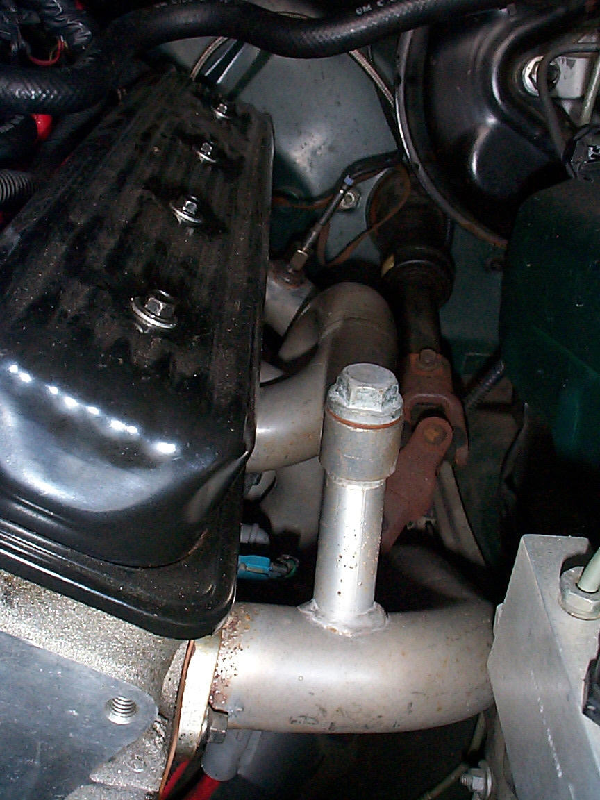

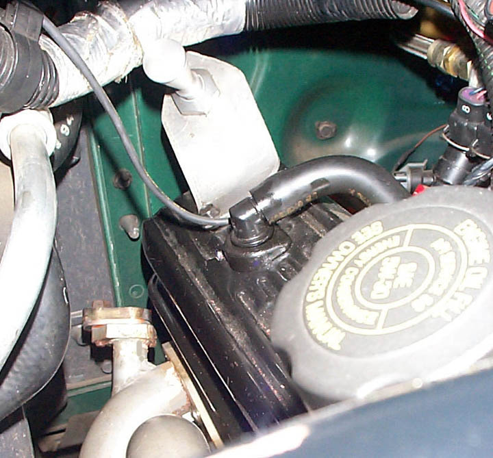

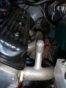

I have AS&M headers, with full emissions. The AIR connections are plugged, and the EGR connection is blanked with a plate.
What was added to #7 primary is an EGT (exhaust gas temperature) bung, with a thermocouple that feeds my MoTeC ECU data logger.
