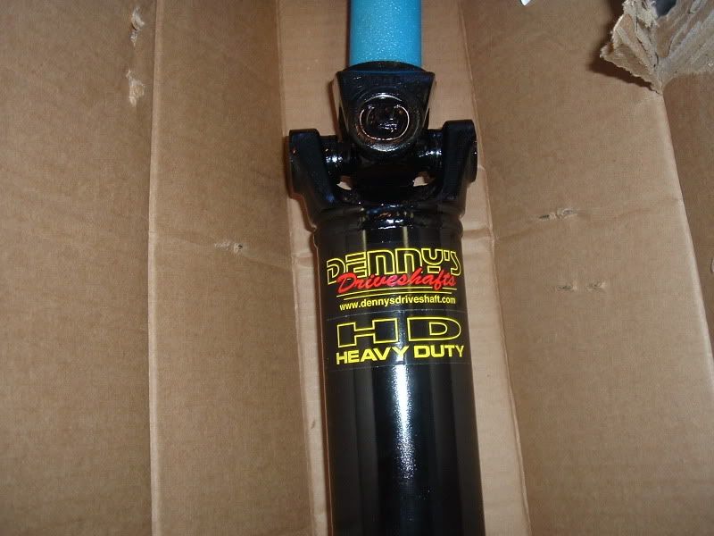

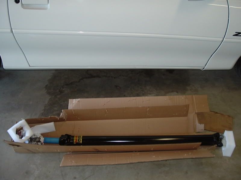

After three years of friggin around I fixed my vibration problem!!
I bought a LS1 driveshaft thinking that would fix my vibration. When it didn't, I assumed that the driveshaft couldn't be the problem and started looking everywhere else.
http://web.camaross.com/forums/showthread.php?t=536982
After an extensive search this summer I concluded both the LT1 and LS1 shafts must be bad. I sent my LS1 shaft to Dennys Driveshaft http://www.dennysdriveshaft.com/
He told me it was no good and built me a custom steel shaft for $350. ($400 with tax and shipping)
Problem solved. I've had it up to 120 with 4.10's, no vibrations.
$350 sounds expensive, but I bought the LS1 shaft used $160 shipped, 60 bucks for joints, $20 for a local truck shop to check it for straightness and balance (it tested good for them.....they didn't spin it fast enough) So i had $240 in a shaft that I had to throw away. Looking at it that way, $350 dosen't seems so bad for a custom made shaft spun to 6500rpm.....
