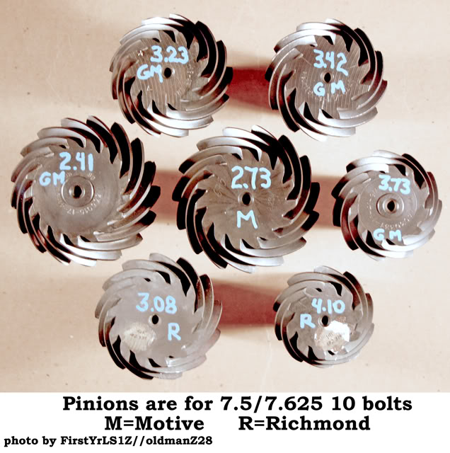

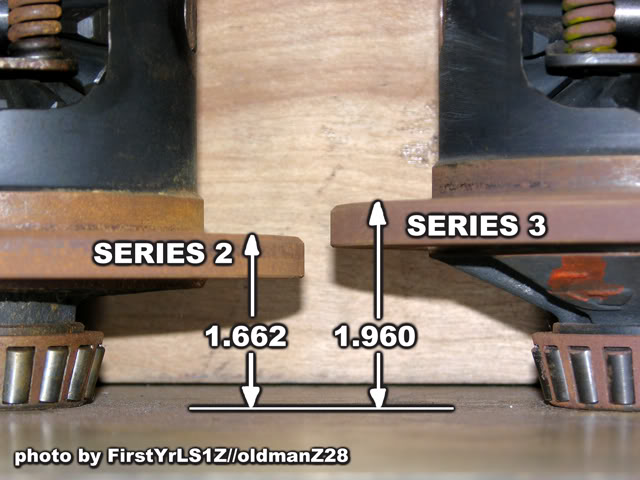

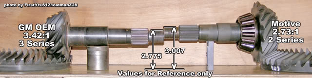

series 2 accomodates the large pinion size of 2.73s' and 3.08s',series 3 gearsets don't have the large pinion size so they were able to move the carrier flange closer to the pinion centerline.
