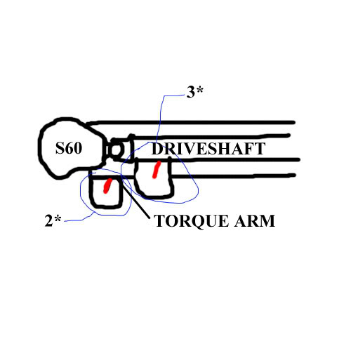

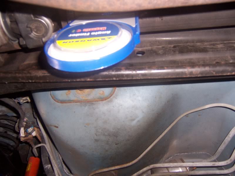

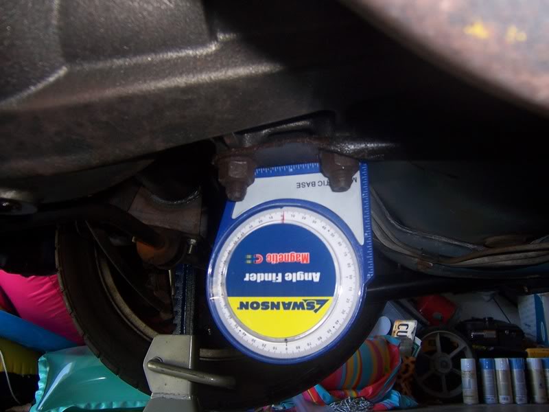

Alright so I finally found some time to get under my car and attempt to measure the pinion angle. Did I do it right, if not, anyone got any tips to do it right?
Basically I stuck the magnetic angle finder on the bottom of the driveshaft and it measured +3degrees. I couldn't get a good way to measure the pinion flange itself and I read somewhere to measure the torque arm itself so that's what I did. Where the TA bolts to the axle I stuck the magnetic angle tool and measured +2degrees.

Am I way off on my measuring or is my pinion angle only 1degree off?

I can't tell from your diagram how you are reading the level. The angles have to be such that the pinion and the driveshaft form a "\/" pointing down. That way, under heavy torque, the pinion nose will rise up and the angle will approach "0". You have a 1* difference, but its hard to tell from the sketch if the "\/" is pointing up or down.
