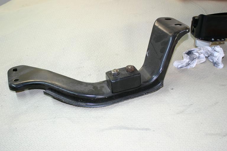

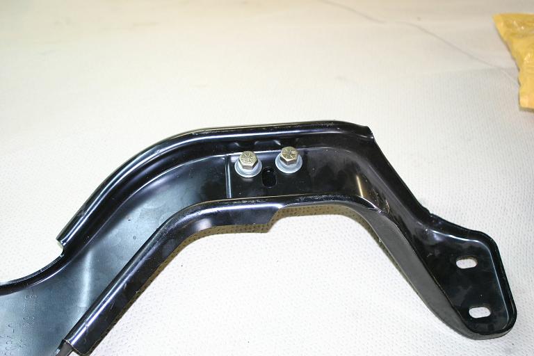

im getting the run around in diff website,, will a 6 speed crossemember work if you are convertering a lt1 style car to a th400.. some people say it will some people say it wont,, does anyone really know.please pm me if you know..

No, it needs to be modified or replaced.

The trans mount hole needs to be elongated on the 6 speed crossmember..

yes you can use it spohn makes a spacer block that will move it up a little higher so the drive line angle is right you need to get a 400 with a 4 inch tail shaft for it to work. I had got this put the trans in my car and then pulled it out I decided to get a BMR one so I know its going to take the power Im going to throw at it.
