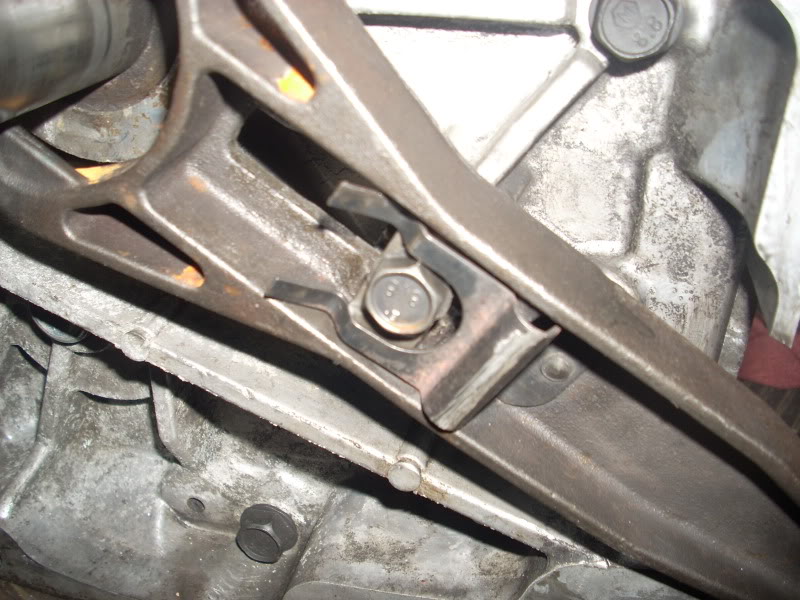

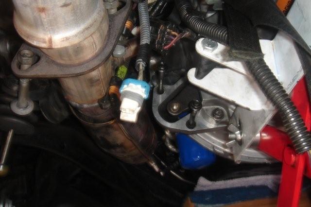

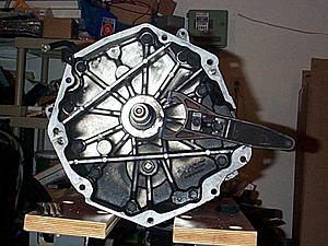

If the clutch fork is not engaged into the t-bolt you're gonna have issues as mentioned. When installing the transmission the clutch fork should not be engaged onto the t-bolt. Image #1 shows clutch fork engaged onto t-bolt. Image #2 shows the metal clip that engages onto the t-bolt. Image #3 shows how clutch fork should be when installing transmission. Once the transmission is bolted to the block, pull the clutch fork back, towards the firewall and slide it up onto the t-bolt. This should engage the clutch fork onto the throw out bearing properly. When installing the slave cylinder, the clutch fork should still be in the forward position.

I find it easier to slide the clutch fork onto the "T" bolt with the tranny about 1/4"-1/2" away from bellhousing. Slide fork on then push tranny in the rest of the way.
There will be some "slop" in the fork but not much. The fork should look like this when viewed after install without slave. Basically flush with the bellhousing without the slave spacer
