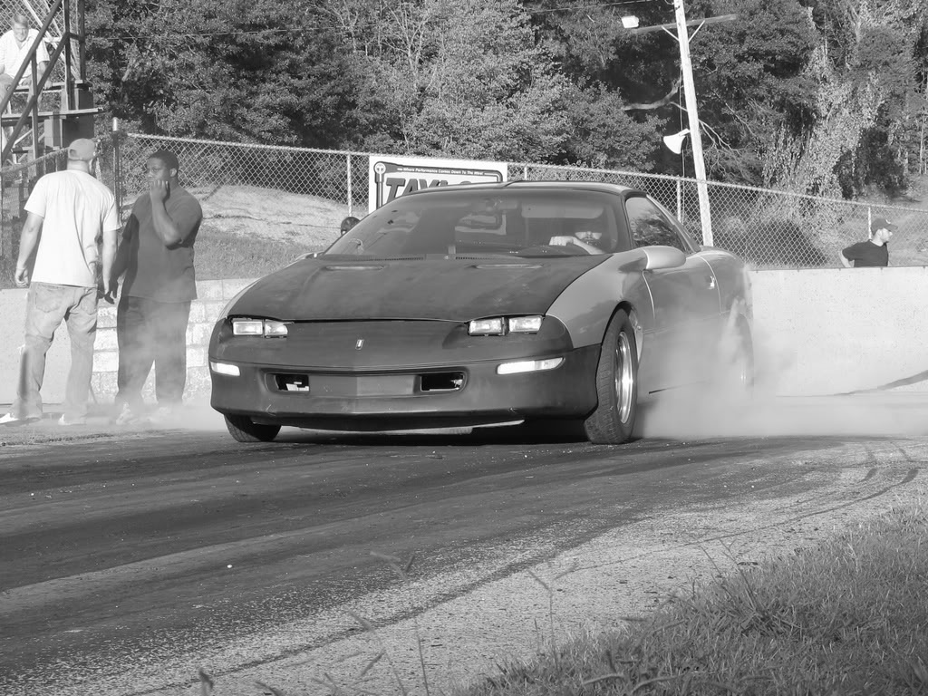

loaded up the 97Z with the LS1 swap in it. Just to see what it would do, no real tuning has been done, just enough to get it down the road so far.
Unload, first pass, runs like POOP, MAF is all messed up but did run 8.4@64MPH. Not bad when I was hoping it would get close to the 7s.
Pull into the pits and turn everything dealing with the MAF off to be in speed density, un plug MAF and go line up. and rips a 7.51 @ 90 w/1.592
:clap:
But from there it was :hsugh:
car would run from the 8.2s to 7.8s and MPH was way down. I think the fuel pump is going out. And it needs alot of tuning!!!
FYI on car now:
97 Z28 chassis stripped!
stock LS1 with Pacesetters/Y-pipe/Hooker areochamber in stock location, LS6 intake, Stock P&P TB, 4.10 in 10bolt and Level 4 A4. Suspension is R series fronts w/275# springs, 12ways on the rear, Spohn TA and Drag Bar. Herron Performance LCA/PHR. Stock K-member and A-arms. Telstars with OLD BFR DRs. Car is in the 3200# range with me in it (guesstimate based on what it weighed with the LT1/12bolt and knowing what all things weigh that were removed and put back in).
Shock settings were all the way tight on front and 6's on the rear.
