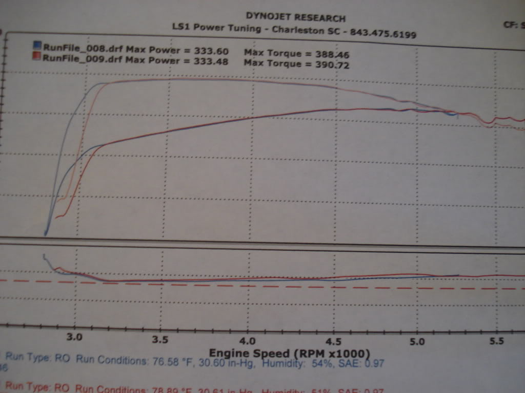

It put down 333 hp and 390 tq, but was really lean (16:1) above 3500. The guy running the dyno said getting the correct a/f ratio would give me another 30-40 hp easy.

333rwhp and you ran a 8.2?

Like I said, the power is really low, but it still has almost 400 ft/lbs. I spun off the line all through 1st (street tires) as well.
