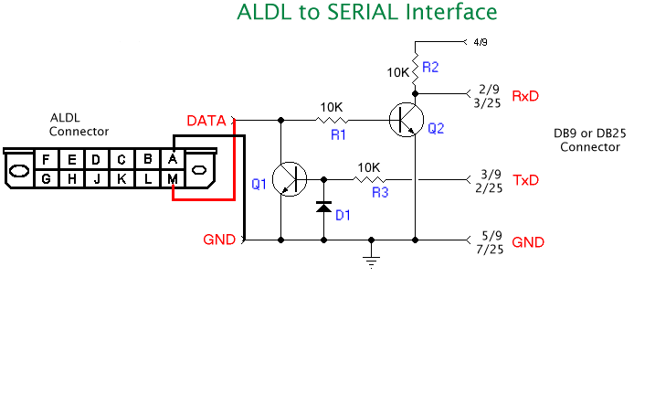

http://winaldl.joby.se/aldlcable.htm would making a cable like this work with a 95? Would this be able to be used with TunerCat to program the transmission n what not?

I bought a cable from ebay that was setup like this but couldnt get it to work with FreeScan
I found this http://cable.invisibill.net/
Made it yesterday and it seems to work fine with freescan, not sure about TunerCATS
$10 worth of radio shack parts, ill try to draw up a schematic, since I was able to modify it and eliminate the cigarette lighter plug and pull power off the serial port
PM me if ya wanna give it a try, ill try to make some instructions

This is what mine ended up turning out like, all that stuff fits in the shell of the DB9 serial connector
