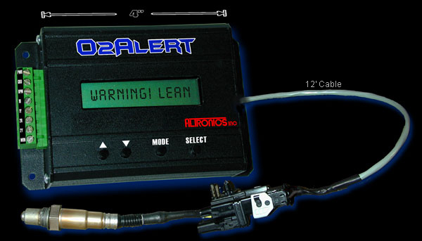

Check in the N2O TEch forum. One of the supporting vendors there was promoting a dual-band wide-band controller. I asked him how it compared to the Altronics O2 Alert, he indicated the unit cost less and had more features. Might be worth a "search".
This is the Altronics unit:
http://www.altronicsinc.com/pages/o2alert.html
