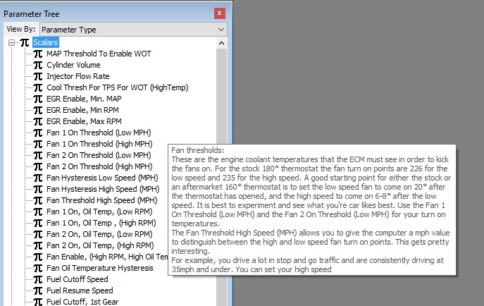

I know how to set the fan on temps, where do I set fan temps off, in the Scalars?
Attached Thumbnails Want to run cooler thermostat need PCM values-scalars.jpg
Old Mar 25, 2016 | 09:23 PM
Posts: 71,098
Re: Want to run cooler thermostat need PCM values
I haven't used the stock PCM in 15 years. But I think there are tables called "fan hysteresis" that allow you to program fan off (delta) temps for high and low MPH.
