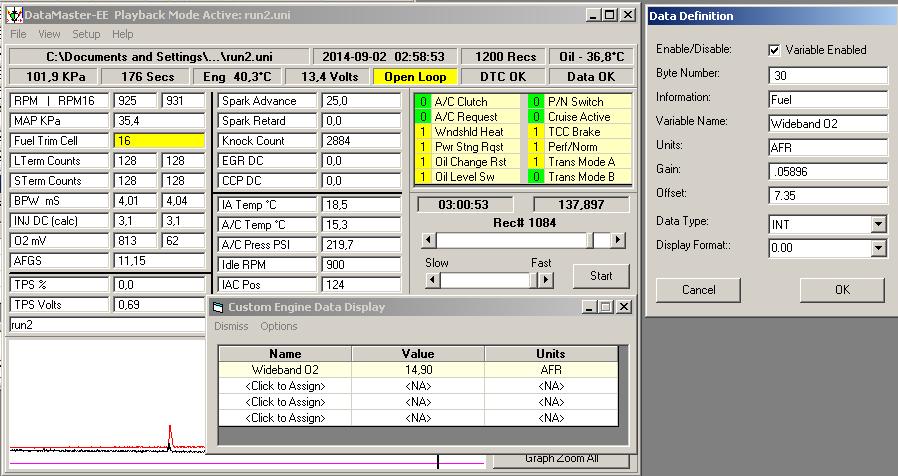

Thanks for this old thread!
-I now can logg my 1994 Z28 with LC-2 wideband O2 sensor
Some remarks:
-The 4.01 version off Datamaster don't work for this, it calculates wrong.
(fixed in 4.10 for international keyboard users)
-The wire for ac pressure is not red/black on a Camaro 1994 Z28, it's plain red.
I used: Datamaster Version 4.10 EE from TTS sytems homepage.

For those of you guys struggling with the math, you can always just tweak your gain up/down until it matches what's on the display of your device. This is assuming that the device you're working with has a display that shows the current AFR value.
- So basically you just need to find your devices AFR value at 0.00v (Should be in the manual for your device)
- Then take that AFR value and put it in the "offset" field.
- Now put in a gain value, start with something like 0.05
- Then start monitoring data and check to see what the AFR value that shows up in DataMaster is compared to the value on your devices display.
- Now just keep tweaking the gain up/down until you get them to match up.
I would suggest starting with some coarse adjustments (0.04, 0.05, 0.06 etc) to get the value within +/- 1.0 AFR. Then you can start making some fine adjustments (0.042, 0.043, 0.052, 0.053 etc) to get it completely dialed in.
Also on my 1997 SS the A/C Pressure Connector wiring was as follows...
BLK - Ground
RED/BLK - Signal Wire (This is what you need to connect your AFR output to)
GRY - 5v Reference
