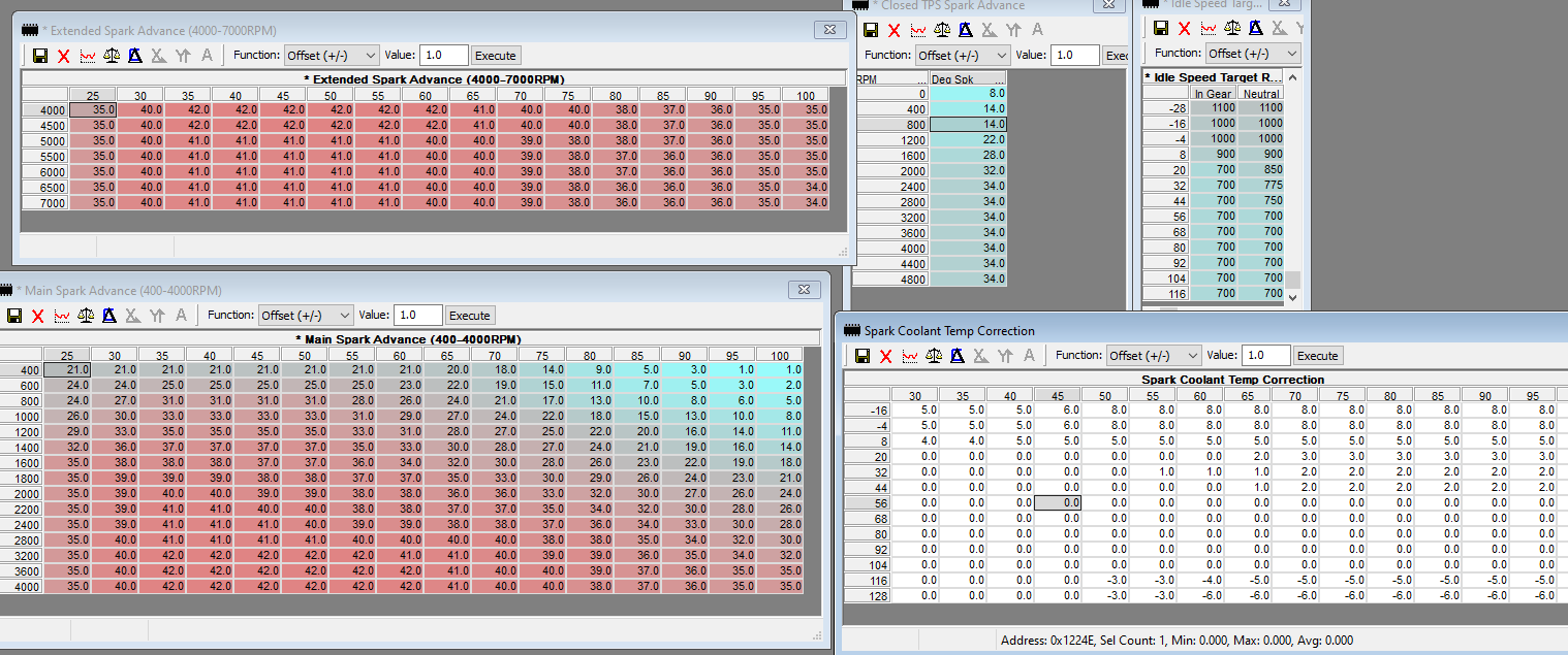

Hello everyone, I have an lt 1 engine with a camshaft CC501 212/218 , Lift .488/.495 LSA 112
Help me set up the spark tables,I have adjusted the VE tables
What kind of spark is needed for idling when the tps is closed

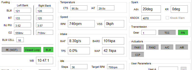

was idle spark 20 tps 0 knock I lowered it to 14 and knock stopped , but the engine is shaking

2 pic 14 spark and 20

Running rich on the wideband, you heard knock… but there is no knock retard at either setting.

In the charts in post #6 both show KR = 0. Or are you assuming the increasing knock counts are the result of audible knock?
