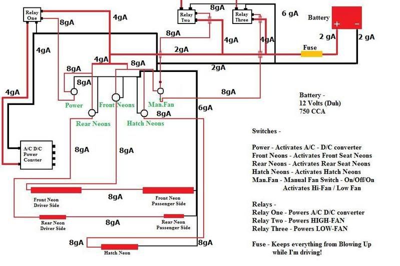

How does this look for a wiring diagram? I am going to setup the following...
Interior Neons - Front Seat, Rear Seat, 1 in the Hatch
Manual Fan Switch.
Power Converter - (I have a laptop, would be nice to beable to charge while I'm driving)
I MIGHT go and super splurge for a Electric Water pump but I'm undecided on that...
Anyone see improvements I could make?

it seems like ur using wirer way thicker then ever needed but otherwise idk

2Ga is WAY overkill for all that; plus I'd just use local grounds, not run huge ground wires everywhere; not worth it.
Probably 8Ga should work for everything as the backbone with 16G for all the 2ndary, and 20Ga for the switch/relay coil wires.
