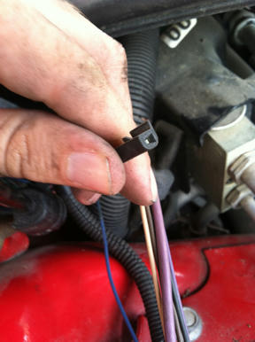

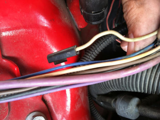

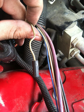

where does this wire go and what does it do?
This is coming out of the wire loom by the computer on the passenger side of the car. Between the computer and the engine.

its the fuel pump prime/test wire, put 12v to it and your fuel pump will run

Re: where does this wire go and what does it do?
Shoebox always has the answers:
http://shbox.com/1/fuel_pump_prime.jpg
