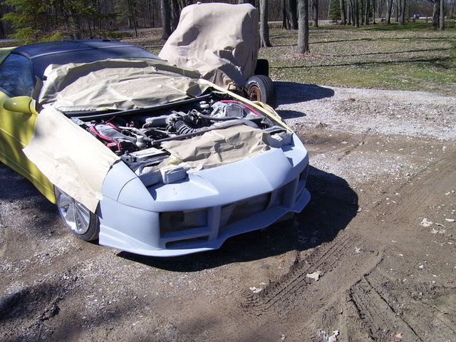

i put a venice front bumper on my 95 and had to remove the soft rubber honeycomb bumper support to get it to fit right. i also had to do a lot of trimming and stuff. fitment was not good- here's a pic. it's all paintd now but i don't have a recent pic.

oh ok thanks they told me i had to remove the reinforcement bar that sits right in front that big long peice is that the same thing as the honeycomb bumper?

yep, i think it's riveted on. i just drilled out the rivets and removed it.

nope, there should be a black rubber/plastic piece on the front of that metal bumper support that is already gone. if that's car you're putting it on you shouldn't have to remove anything. my bumper fit terrible. i had to trim some of the fiberglass and add some in other areas to get it to fit right. check and make sure you're not getting hung up on any other areas.
good luck.
