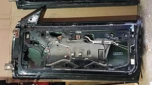

not sure but im guessing its the 94 camaro your talking about . the biggest difference in the switch over is that the power door motor and the manual crank mount in different holes. you could see the rivets from the power and the holes outlined in red is where the manual mechanism mounts. drill or grind out the power regulator and use 1/4 rivets to rivet in the new one. getting the mechanisms in and out is also a trick. you may have to raise the window, support it with suction cups and disconnect the mechanism. power it up and close it and it will be easier to get out

That is a start. It is actually for my 2000 Firebird but the pic you attached looks like it fits the bill.
