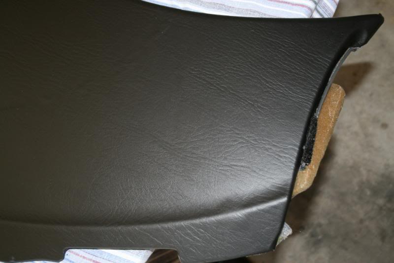

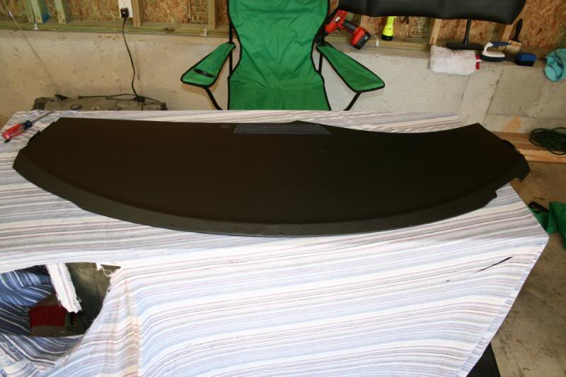

3.SPRAY ON adhesive!, follow directions for max strength. Spray both vinyl and dash pad 2 good coats. let dry for 5-10 mins until tacky, then press on firmly. TAKE YOUR TIME, start in the middle and work you way out getting all the air bubbles out( hair dry works great)
flip over trim edges leaving enough overhang
now with the over hang I used a hot glue gun to hold it down works great and drys fast..
trim the rest to fit and finish folding over the flaps,

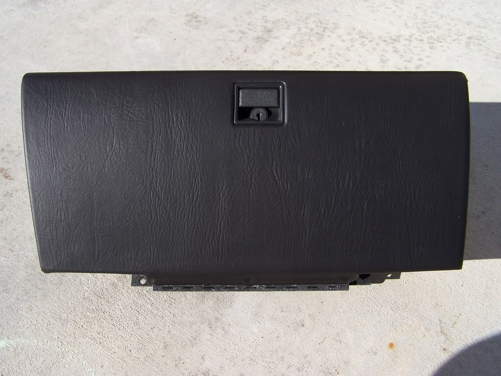

brand new dash!!!
The best part of this vinyl is that its flexible, and will withstand direct sunlight while providing support for the cracked dash underneath.
Enjoy your sweet newish dash pad without the cracks!
If I missed anything let me know and I'll try to answer your questions, I'm not really good on writing these how to's....lol
