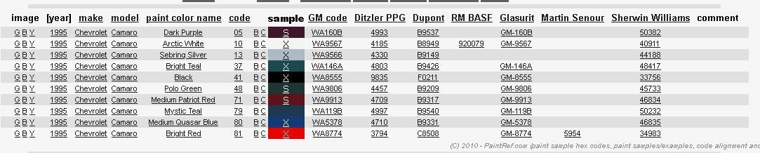

I found a chart here
https://paintref.com/cgi-bin/colorco...on=yko&rows=50
It says WA- U146A on the sticker in my glove compartment. The closest thing on the chart is WA146A, which is Bright Teal.

Re: Need help from green/teal Camaro owners... what color is this?
The “U” means “upper exterior paint color”. It's for the location of the color, not the color itself. That's a vestige of ye olde days, when it was not unusual for a factory paint job to be offered as .“two-tone” = different upper and lower colors.

37U is GM paint code WA146A, so still Bright Teal Metallic (Firebird color name: Dark Aqua Metallic). There's often a letter thrown in toward the beginning like a U or an L just to add some confusion. Like Injuneer said, it's a remnant from the two-tone days of the 80s and whatnot.
