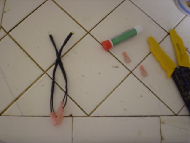

i pop open the cover and cut the bulb out and started to put the connectors on and clip them down!
and this is what you are going to end up after putting the connectors.

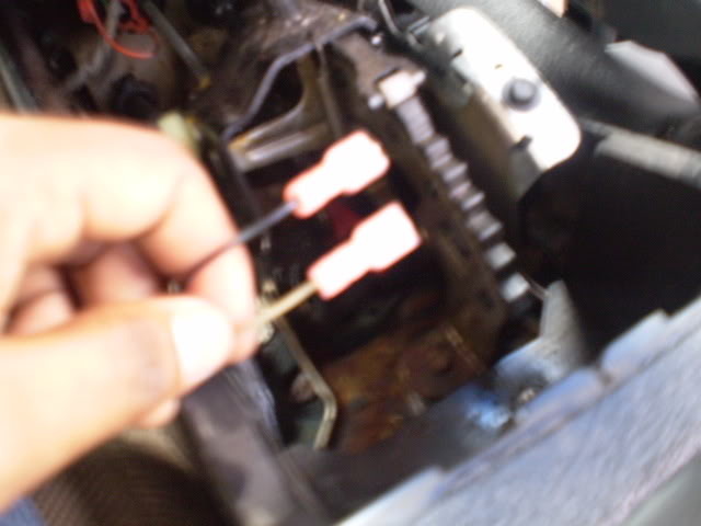

and slide it to the light hole where the factory light was at. you can super glue it or just put some kind of housing to clip it on their!
oppss!! the led lights i use burn out so you must find a 9v led or more, which might be lil bigger but won't burn out!
