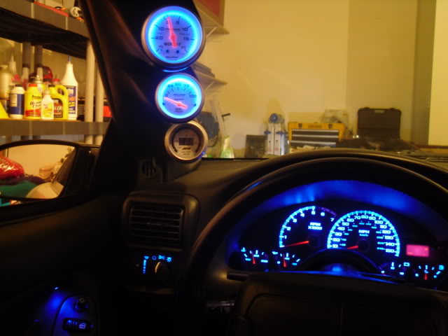

Blue 5 LED 194/168 12V 4W (T10 Wedge) Wide View Angle Bulbs. I have 7 of these in my gauge cluster. I think I got 20 of them off ebay for $40 or something. I haven't replaced any of the other interior lights. Make sure you get some that disperse the light over a wide area.. mine have 5 LEDs each so they do a relatively good job but they could be better. I don't know what else is out there and haven't looked into it in a long time though cuz I'm happy enough with them. Also, you can get the bases at auto parts stores and you can use the old bases if you can get the old bulbs out of them.

It was pretty easy and I used ebay leds since they were cheap. Hardest part was changing the leds in the fog light switch <--required soldering
Here's how it looks.

Originally Posted by camaro_chic17
I think you might have a couple leds in wrong. it should light up evenly.
It probably would, but my gauge cluster isn't perfect. I can't turn one of the bases all the way or it doesn't light up and I don't know how to fix the silver contact thing on the back. Do you know how??
They were kinda finnicky and that's why I bought extra bases and messed with it until I got it as good as possible. I took it apart about 4 times last fall after replacing 2 or 3 of them trying to make it "perfect" and this is as good as it gets. I originally did this about 5 years ago so having to replace a couple wasn't unexpected. I do love the color these blue LEDs provide.
You do not take the clear part off to do this. If I remember right you take the pillar out, prop the dash pad up, take the part of the dash under the steering wheel and the part over the steering wheel out (and unclip the switches) and you take the part over the radio off so you can take one of those around the steering wheel off, and there are four bolts holding the guage cluster in.

^^^That's pretty much it. Since they're leds you might have to install cluster & turn on lights to verify operation. If it doesn't look like it's lit up take it back apart, take out led, turn 180 degrees, and reinstall. <--I had to do this a couple times to get all the lights to work.
