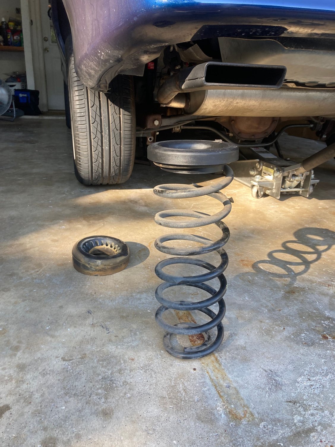

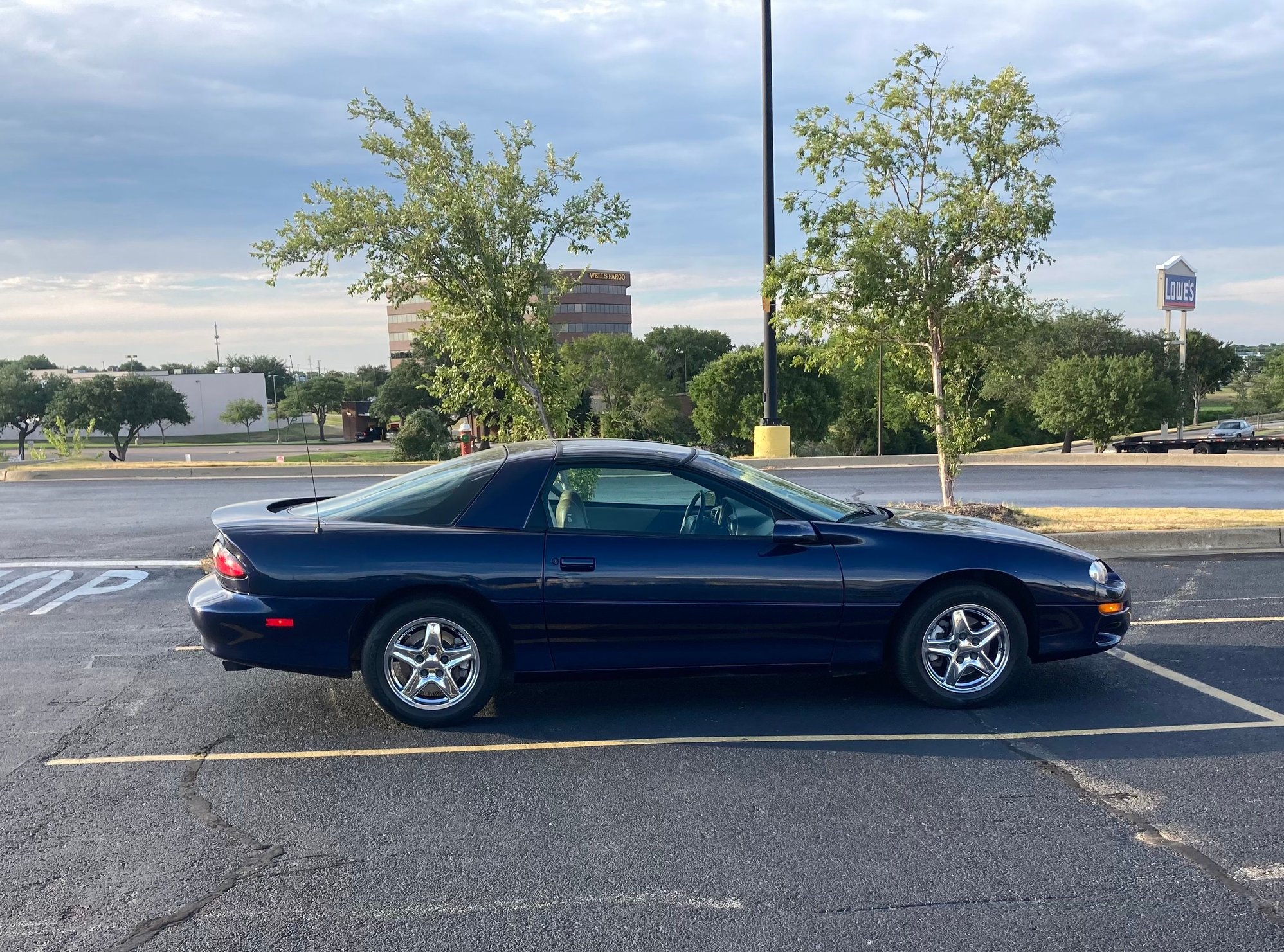

I dove in head first
Well I ordered and installed Prothane rear spring isolators for a ‘99 Cobra and this is what we got. The rear is indeed a tad lower than then front but not too much. The ground isn’t then most level in the pics but it’s all I have on hand at the moment.

Re: 4th Gen Spring Isolator/Heater Hose Mod-
Prothane
6-1709-BL
https://www.summitracing.com/parts/p...ABEgLhMPD_BwE.
t
I think it looks ok enough but the it hits a little harder over bumps in the rear than it did with the stock ones.

Oh nah. I was saying that the ride is rougher with the poly isolators than it was with the old oem’s.
