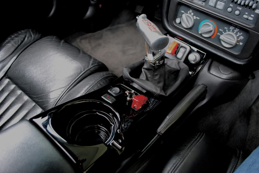

I don't know how much of a help this is, but this is what I've heard (which isn't much because I own a M6. So take this as a grain of salt as I could be thinking of something else). I have read that people have done it, but it isn't a direct swap. Here is some pictures of something similar (I think) and lots of people consider this one of the cleaner installs:

Thanks for the info and thanks especially for the pic, Counted Out.
The shifter base and boot was one of my concerns and the pic pretty much covers it. I guess that I either got fab work to do or just go with another type of shifter.

It will work, you just need to use a manual shift bezel and boot assembly. Also you will have to get a little creative with the mounting. It has been done many times, Try a search in the drivetrain forum.
