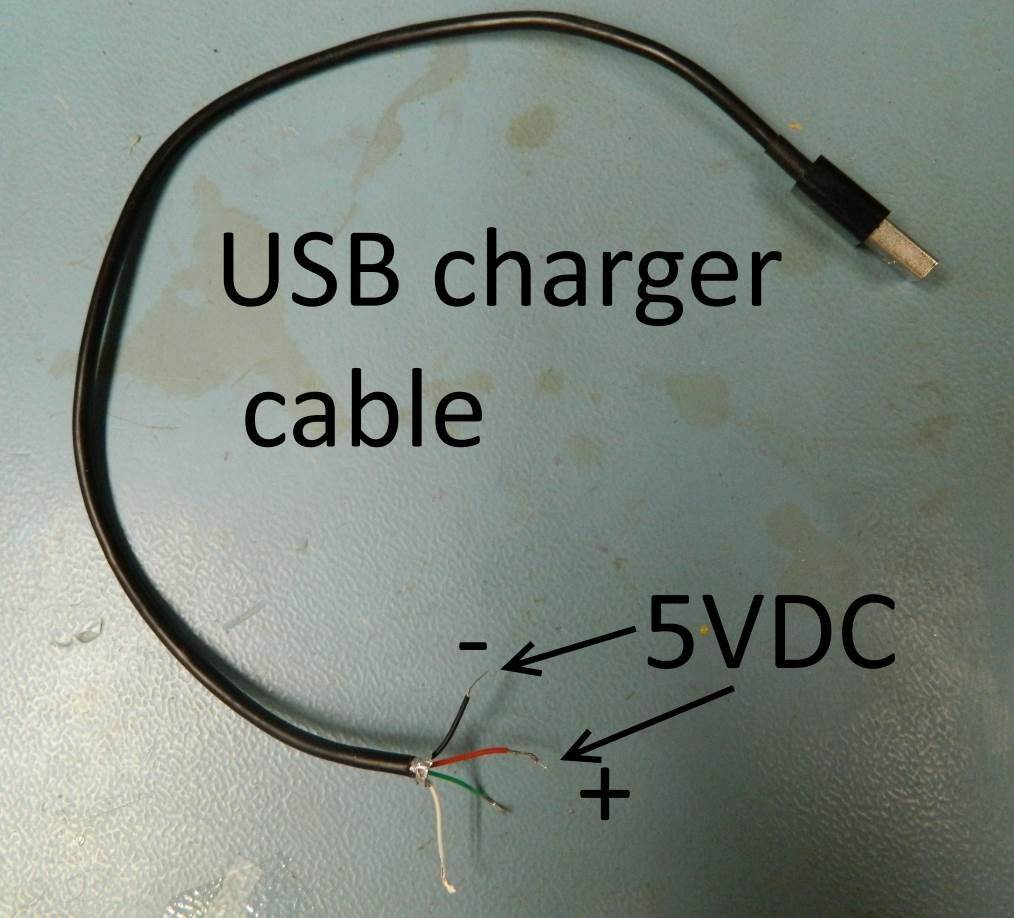

You are right and I am wrong..old ageism at work again ;-) You need 5vdc like the PCM ref. You can get that from an ordinary wall charger like the one for your phone. Get a charging cable ($3), cut it open and use the black and red wires.

I'll wanna check the Amp output from the PCM. I'm not sure if the contact position B29 from the PCM has a >2.5A output. I wouldn't wanna fry the solid state device if it's not rated for 2.5+A. I was out today and didn't think to go pick up and injection meter or small v a small variable DC power supply. I need one for some other projects anyway. I would suspect the reference voltage/current from the PCM is less than 0.5a, and could be milliamps.
I'm also not sure if that 5VDC is there with ignition on, or other configurations have to be met first, I'll check voltage and current on B29 tomorrow with ignition on and see if it's outputting, which it ties into the SFI there as well at S117 so I'm hopeful for 5VDC and a measurable current output.
